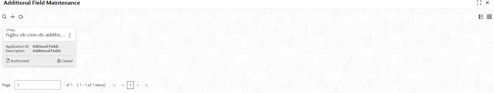

  1. From Home screen, click Core Maintenance. Under Core Maintenance, click Additional Field Maintenance.
    The Additional Field Maintenance screen is displayed.
    Figure 1-6 Additional Field Maintenance
    Description of Figure 1-6 follows
    Description of "Figure 1-6 Additional Field Maintenance"
  2. View the details from the Additional Fields Maintenance screen
    Table 1-6 Additional Field Maintenance - Field Description
    Field Description
    UI Key Displays the UI key of the additional field.
    Application ID Displays the related application ID of the additional field.
    Description Displays the description of the additional field.
    Status Displays the status of the record.

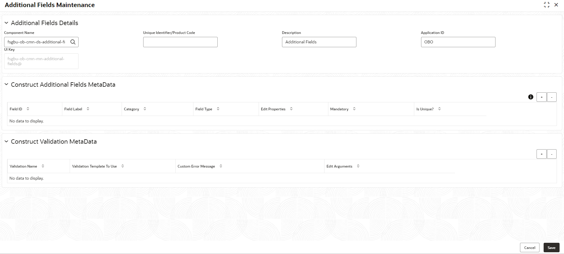

  3. On the Additional Field Maintenance screen, click + button.
    The Additional Fields Maintenance screen is displayed.
    Figure 1-7 Additional Fields Maintenance
  4. Specify the fields on the Additional Fields Maintenance screen.
    The fields marked as Required are mandatory.
    Table 1-7 Additional Fields Maintenance – Field Description
    Field Description
    Component Name Click Search icon to view and select the component name from the list of
    Product Code Click Search icon to view and select the product code from the list of
    Product Name Displays the product name for the specified product code.
    Description Displays the description as Additional Fields, and it can be modified.
    Application ID Displays the Application ID.
    Construct Additional Fields MetaData Specify the details under this section to configure metadata for each field.
    Select Check this box to select/deselect a row.
    Field ID Specify the field ID.
    Field Label Specify the field label.
    Category Specify the category.
    Field Type Select the field type from the drop-down values.
    Edit Click this icon to edit the fields in the row.
    Mandatory Check this box if the field needs to be configured as mandatory.
    Construct Validation MetaData Specify the details under this section for validations to be applied on configured fields.
    Select Check this box to select/unselect a row.
    Validation Name Specify the validation name.
    Validation Template To Use Select the template to be used for the validation.
    Custom Error Message Specify the error message that needs to be displayed for the lidti
    Edit Arguments Click this icon to edit the fields in the row.
  5. Perform one of the following action:
    • Click Save to save the details.
      The user can view the confirmation advice details in the Additional Field Maintenance.
    • Click Cancel to discard the changes and close the screen.
