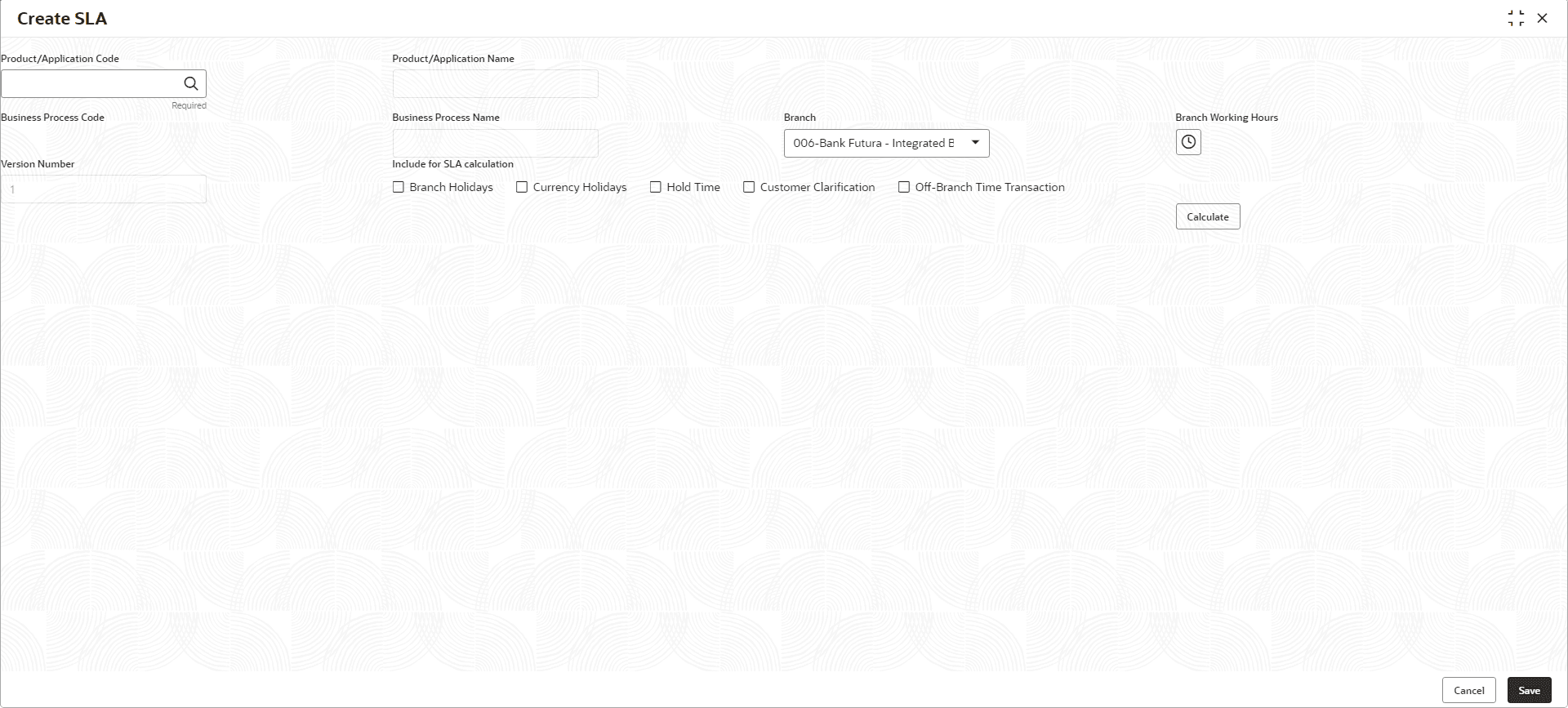

  1. From Home screen, click Core Maintenance. Under Core Maintenance, click SLA Maintenance.
  2. Under SLA Maintenance, click Create SLA Maintenance.
    The Create SLA Maintenance screen is displayed.
    Figure 1-93 Create SLA Maintenance
  3. Specify the fields on the Create SLA Maintenance screen.
    The fields marked as Required are mandatory.
    Table 1-94 Create SLA Maintenance – Field Description
    Field Description
    Product/Application Code Click Search icon and select the Product or Application Code.
    Product/Application Name Displays the name of the Product/Application.
    Business Process Code Click Search icon and select the Business Process Code for which the SLA maintenance has to be made.
    Business Process Name Displays the Business Process name based on the Business Process code selected.
    Branch Select the branch code for which SLA maintenance has to be done.
    Branch Working Hours Click the icon to view the branch working hours.
    Include for SLA Calculation Select the checkbox to consider the below options for the SLA calculation.
    The available options are:
    • Branch Holidays
    • Currency Holidays
    • Hold Time
    • Customer Clarification
    • Off Branch Time Transactions
  4. Click Calculate to view data will appear for the selected Business process code
  5. Perform one of the following action:
    • Click Save to save the details.
      The SLA Maintenance is successfully created and can be viewed using the View SLA Maintenance screen.
    • Click Cancel to discard the changes and close the screen.
