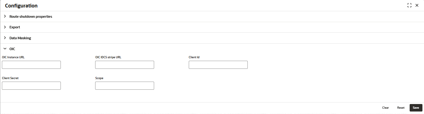

  1. From Home screen, click Core Maintenance. Under Core Maintenance, click Interconnect .
  2. Under Interconnect , click Routing Hub. Under Routing Hub, click Configuration.
    The Configuration screen is displayed.
  3. On Configuration screen, specify the fields.
    The fields marked as Required are mandatory.

  4. Perform one of the following action:
    • Click Clear to clear all the specified details.
    • Click Reset to reset the details.
    • Click Save to save all the details.
