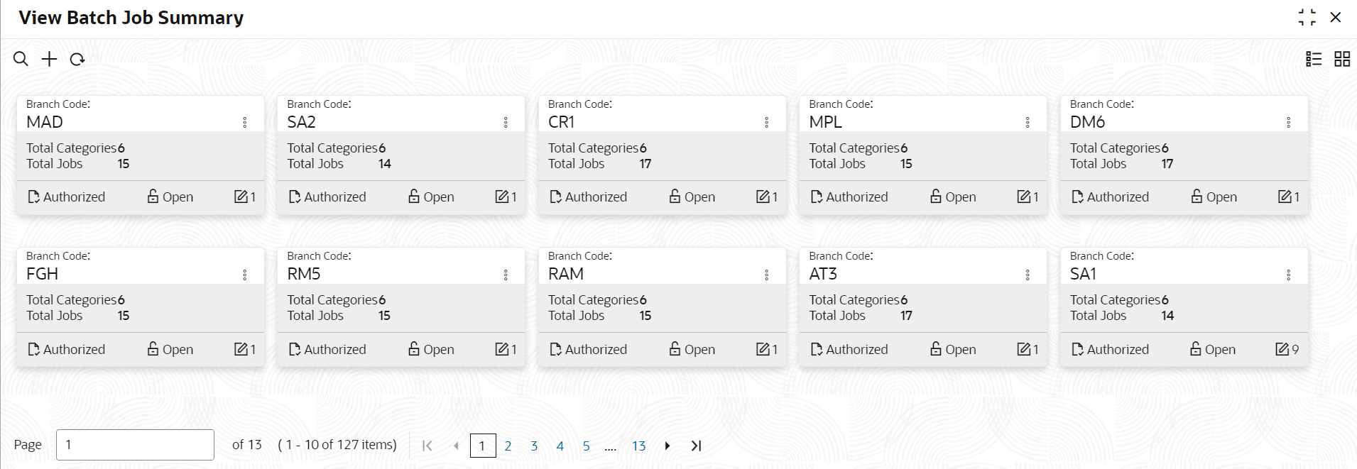

This topic describes the systematic procedures used to view batch job summaries.
Note: Refer the Batch Job Details attachment for the configuration details of batch jobs.
  1. From Home screen, click Retail Lending. Under Retail Lending, click Maintenance.
  2. Under Maintenance, click Batch Category, then click View Batch Job Summary.
    The View Batch Job Summary screen is displayed.
    Figure 3-206 View Batch Job Summary
  3. Specify the fields on the View Batch Job Summary screen.
    Table 3-189 View Batch Job Summary - Field Description
    Field Description
    Branch Code Displays the branch code.
    Total Categories Displays the total number of categories.
    Total Jobs Displays the total number of Jobs.
    Authorization Status Displays the authorization status of the record.
    The options are:
    • Authorized
    • Unauthorized
    Record Status Displays the status of the record.
    The options are:
    • Open
    • Closed
    Modification Number Displays the number of modification performed on the record.
