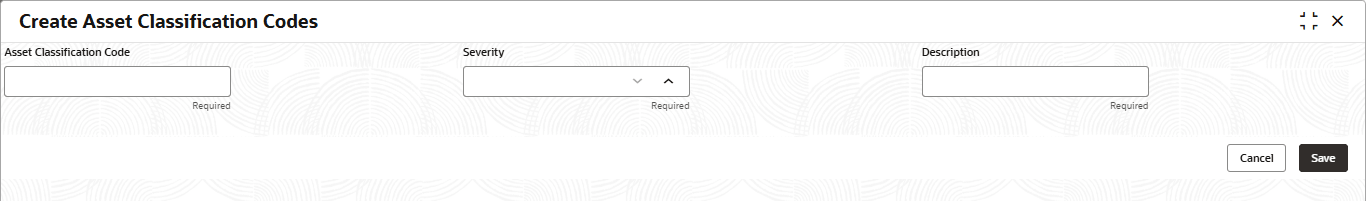

    The Create Asset Classification Codes screen is displayed.
    Figure 1-12 Create Asset Classification Codes
  3. Specify the fields on Create Asset Classification Codes screen.
    The fields marked as Required are mandatory.
    Asset code NORM is a mandatory input for delinquency processing as the initial starting status code.
    Table 1-12 Create Asset Classification Codes - Field Description
    Field Description
    Create Asset Classification Codes Specify the status codes for classifying an asset.
    Severity Specify the severity level of status codes for classifying an asset.
    Description Specify the description of the status codes.
  4. Click Save to save the details.
    The Asset Classification Codes is successfully created and can be viewed using the View Asset Classification Codes screen.
