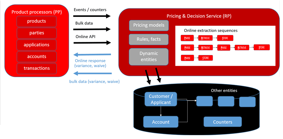

    Attribute retrievals can be depicted in the form of the following diagram:
    Figure 3-181 Relationship Pricing - Data Flow
    RP module has 2 types of attribute retrieval configurations:
    • Online attribute retrievals - Attributes are retrieved from 3 sources:
      • Reading data off events - RP has ability to subscribe to topics dynamically. It also has the ability to configure the source of attributes from a kafka payload.
      • Invoking URLs and reading attributes off response values - RP has the ability to configure a sequence that can either parse, retrieve, store in any order for attribute retrievels.
      • Modules directly populate fact values - RP exposes an API for module to directly populate fact and its value in the module.
    • Bulk attribute retrievals - Attributes are retrieved in bulk. In this mode, RP uses the "Transfer" and "Transform" modes to populate the stages through which data is transferred.
      The stages are:
      • Raw data zone - In this zone, data is held for some time and has the same structure as the source. This is regularly cleaned up after the attributes are transferred to the processing zone. The "Transfer" mode facilitates this. This mode uses the fast data transfer configuration.
      • Processing zone - This zone has RP data held in a construct called as aggregates. The aggregate has a generic structure that is understood by the RP module and is used by the processing routines. Data is transferred from the raw data to the processing zone by a batch job called "Fact augmenter", which involves some basic transformation routines and places data in the aggregates. The fact augmenter job is the "Transform" mode and is executed in the nightly batch.

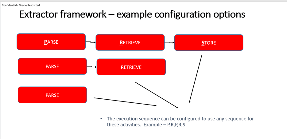

Screen:Execute Sequence Configuration
ExecutionSequence configuration is essentially an extractor framework that uses a sequence of execution of parse, retrieve and store configurations. This configuration allows the user to create chain of sequential parse, store, retrieve operations in the steps to retrieve attribute data. Given below is a a depiction of the extractor framework.
Figure 3-182 Extractor Framework - example configuration options
Table 3-156 Create Parse Configuration Screen
Field Value Description
Execute Sequence ID ObpyRetOnboard Specify the unique execute sequence ID.
Product Processor OBRL Select the product processor from the drop-down list for which configuration is being created.
Execute Sequence Number Execute Step ID Execution Type Execute Sequence Number Specify the unique sequence number for the execute sequence table.
Execute Step ID ObpyRetOnboardParse PARSE 1 Specify the unique step ID for the execute sequence table.
Execution Type ObpyRetOnboardStore STORE STORE Select the type from the drop-down list. The available options are:
