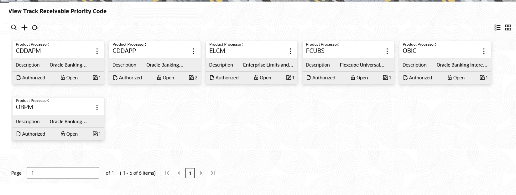

    The View Track Receivable Priority Code screen is displayed.
    Figure 1-117 View Track Receivable Priority Code

  3. On the View Track Receivable Priority Code screen, click Three dots icon to Unlock, Delete, Authorize, Copy or View the created Priority Code.

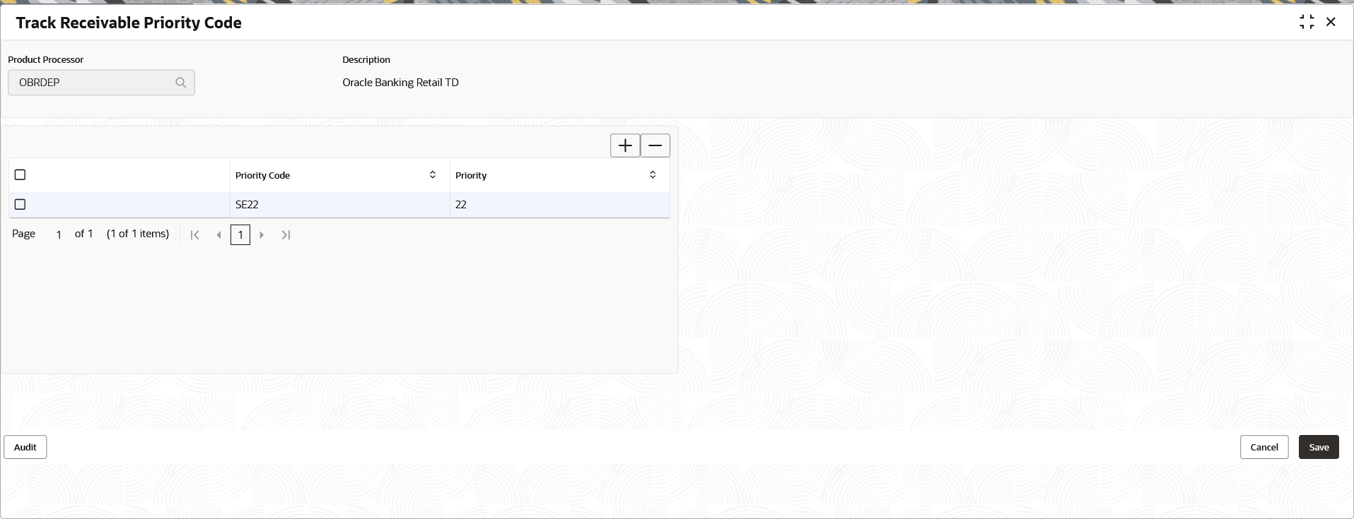

  4. Click Unlock to modify the created priority code.
    The Track Receivable Priority Code - Modify screen is displayed.
    Figure 1-118 Track Receivable Priority Code - Modify
    Table 1-121 Track Receivable Priority Code – Modify - Field Description
    Field Description
    Product Processor Displays the product processor.
    Description Displays the description of the selected product processor.
    Priority Code Specify the unique priority code for the selected product processor.
    Note: A single priority code can be linked to multiple products (example, PR02 can be linked to Interest and Charges).
    Priority Specify the priority for the Priority Code.
    Note : This allows value between 00 to 99. And a lower numerical value denotes a higher settlement priority (example, '01' is processed before '10').
  5. Click Save to save the details.

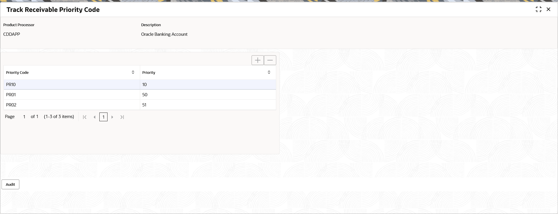

  6. Click View to view the created priority code.
    The Track Receivable Priority Code - View screen is displayed.
    Figure 1-119 View Track Receivable Priority Code -Details
    Table 1-122 Track Receivable Priority Code - View - Field Description
    Field Description
    Priority Code Displays the unique priority code for the selected product processor.
    Priority Displays the priority for the Priority Code.
