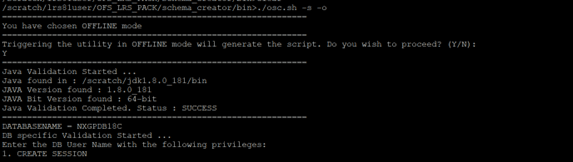

To execute the schema creator utility in the offline mode:
  1. Log in to the system as a non-root user.
  2. Navigate to the path: OFS_<APP_PACK>_PACK/schema_creator/bin
  3. Execute the osc.sh file using the command: ./osc.sh -s -o
    The following message is displayed:
    You have chosen OFFLINE mode. Triggering the utility in OFFLINE mode will generate the script. Do you wish to proceed? (Y/y or N/n).
  4. Enter Y to proceed.
  5. Enter the DB Username with SELECT privileges.
  6. Enter the User Password.

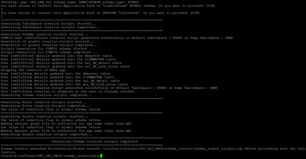

  7. The console runs the initial validation checks and displays the following message:
    You have chosen to install this Application Pack on <Name of the Atomic Schema> ATOMIC schema. Do you want to proceed? (Y or N).
    Figure 7-4 Schema Creation in Offline Mode Script Generation
  8. Enter Y to start the script generation. The following message is displayed:
    You have chosen to install this Application Pack on <Name of the Infodom>. Do you want to proceed? (Y or N).
    Figure 7-5 Schema Creation in Offline Mode Successful

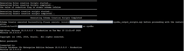

    On successful execution of the schema creator utility, the console displays the following status message:
    Schema Creator executed successfully. Please execute scratch/ofsaaapp/OFS_LRS_PACK/schema_creator/sysdba_output_scripts.sql before proceeding with the installation.

  9. Navigate to the OFS_AAAI_PACK/schema_creator OFS_LRS_PACK/schema_creator directory.
  10. Log in to SQLPLUS as a user having SYSDBA Privileges.
    Figure 7-6 Schema Creation in Offline Mode – Execute sysdba_output_scripts.sql
  11. Execute the sysdba_output_scripts.sql file using the following command:
    SQL>@sysdba_output_scripts.sql
    Alternatively, you can copy the sysdba_output_scripts.sql file and SQLScripts directory to a remote server and execute the sysdba_output_scripts.sql file, after providing appropriate execute permissions.
