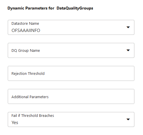

DataQualityGroups
Figure 8-5 Dynamic Parameters for RUN DQ RULE
Table 8-4 Dynamic Parameters for RUN DQ RULE Description
| Property | Description |
| DQ Group Name | Refers to the Data Quality Groups consisting of associated Data Quality Rule definition(s). Select the required DQ Group from the drop-down list. |
| Rejection Threshold | Specify the percentage of the Rejection Threshold (%) limit in numeric value. This refers to the maximum percentage of records that can be rejected in a job. If the percentage of failed records exceeds the Rejection Threshold, the job fails. If the field is left blank, the default value is set to 100%. |
| Additional Parameters |
Specify the Additional Parameters as filtering criteria for execution in the pattern Key#Data type#Value; Key#Data type#Value;…etc. Here the Data type of the value should be “V” for Varchar/Char, or “D” for Date with “MM/DD/YYYY” format, or “N” for numeric data. For example, if you want to filter some specific region codes, you can specify the Additional Parameters value as $REGION_CODE#V#US;$CREATION_DATE#D#07/06/1983;$ACCOUNT _BAL#N#10000.50; Note: In case the Additional Parameters are not specified, the default value is fetched from the corresponding table in the configuration schema for execution. |
| Fail if Threshold Breaches |
Select Yes or No from the drop-down list. If Yes is selected, execution of the task fails if the threshold value is breached. If No is selected, the execution of the task continues. Note: For Custom Check type DQ Rules in Hive Infodoms, the execution of the task does not fail even if the threshold is breached. This is a limitation. |
| Parameters |
Select the Data Fields you want to pass as parameters for the selected Data Mapping definition. For information on creating Data Fields, see the Data Fields section. |
