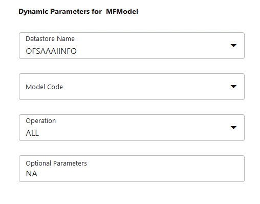

In the Process Flow window, click the MFModel icon in
Widget from the toolbar and Drag and drop it onto the canvas.
Double-click the widget to display the Activity window.
Figure 8-3 Dynamic Parameters for MODEL
Table 8-2 Dynamic Parameters for MODEL Description
| Field Name | Description |
| Datastore Name | Select the Information Domain in which the RRF Rule you want to execute is present, from the drop-down list. |
| Model Code | Display the codes of the EMF Models defined under the selected Infodom. |
| Operation |
The All definition for the Operation field conveys the process of extracting the data from the flat files and applying the run regression on the data extracted. For Batches that are being built for the first time the data is extracted from the flat files and the run regression is applied on it. |
| Optional Parameters |
Select the Data Fields you want to pass as parameters for the selected Data Mapping definition. For information on creating Data Fields, see the Data Fields section. |
