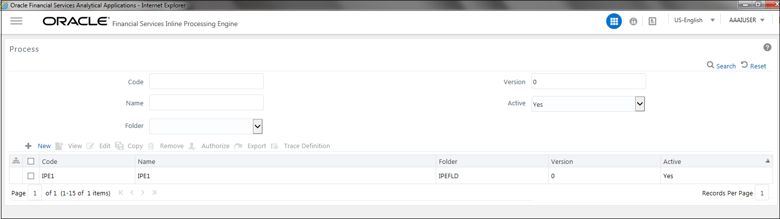

  1. Navigate to the OFSAA Home Page and select IPE Execution from Select Application drop-down list.
  2. Select Process Management under it and then Orchestration.
  3. Select Process Definition. The Process Definition page is displayed.
    Figure 12-1 Process Definition page

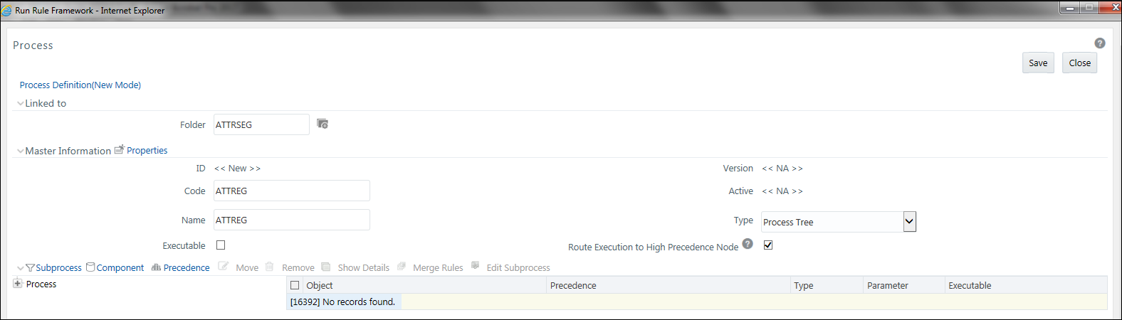

  4. Click New on the List tool bar. The Run Rule Framework window is displayed.
    Figure 12-2 Process Details Run Rule Framework page

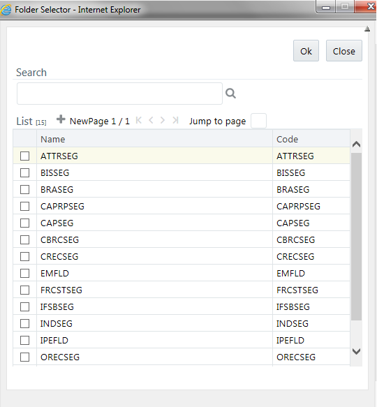

  5. Under the Linked To tool bar, click on the button next to Folder. The Folder Selector dialog box is displayed.
    Figure 12-3 Folder Selector window
  6. Select the folder that is to be linked to the process.
  7. In the Master information tool bar, enter the code and name of the process.

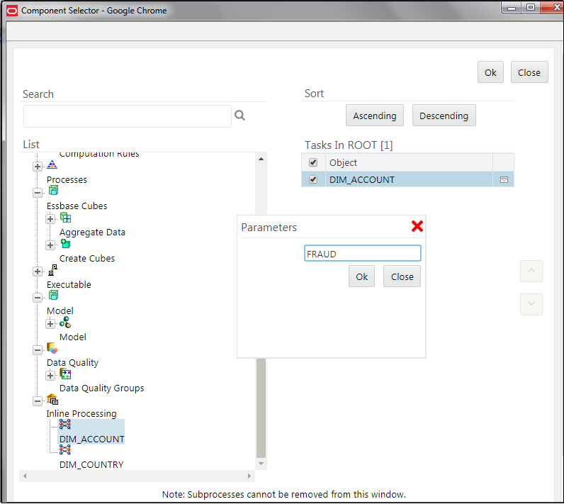

  8. Click Component on the tool bar. The Run Rule Framework Dialog box is displayed.
    Figure 12-4 Process RRF
    Process RRF
  9. Click Inline Processing from the List on the left and select the activity that is to be executed. The activity is displayed on the right under Tasks in ROOT.
  10. Click on the button next to the activity. The parameter dialog box is displayed. To enter these details, see section Passing Parameters from Run Rule Framework (RRF) to IPE.
  11. Click OK. The activity is displayed under Process.
