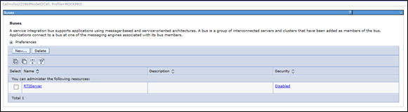

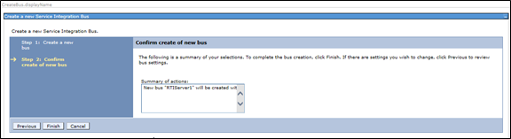

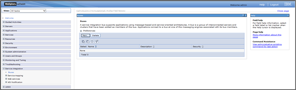

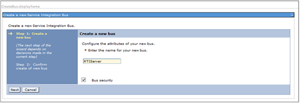

Inline Processing Engine Configuration Guide Configuring IPE in Web Application Servers for Real Time Mode Configuring IPE in WebSphere Bus Creation 4.2.2 Bus Creation For Bus Creation, execute the following steps. Click + to expand Service Integration in the LHS menu. Click Buses. The Buses page is displayed. Click New. The Create a New Service Integration Bus screen is displayed. Enter the name as RTIServer. Un-check Bus security. Click Next. Click Finish. Click Save. Parent topic: Configuring IPE in WebSphere
