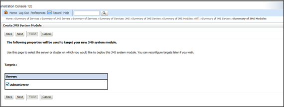

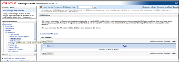

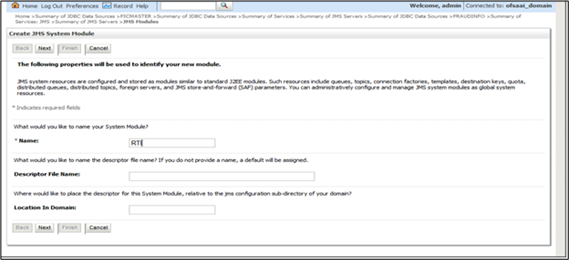

Inline Processing Engine Configuration Guide Configuring IPE in Web Application Servers for Real Time Mode Configuring IPE in WebLogic Configuring JMS Modules 4.1.3 Configuring JMS Modules To configure JMS Modules, follow these steps: In the Domain Structure LHS menu, click + to expand Services. Click + to expand Messaging. Click JMS Modules. The JMS Module screen is displayed. Click New. The Create JMS System Module page is displayed. Enter the name as RTI. Click Next. The Create JMS System Module page is displayed. Check the AdminServer in the Servers section. Click Next. Click Finish. The following confirmation message is displayed. JMS Module is created successfully. Parent topic: Configuring IPE in WebLogic
