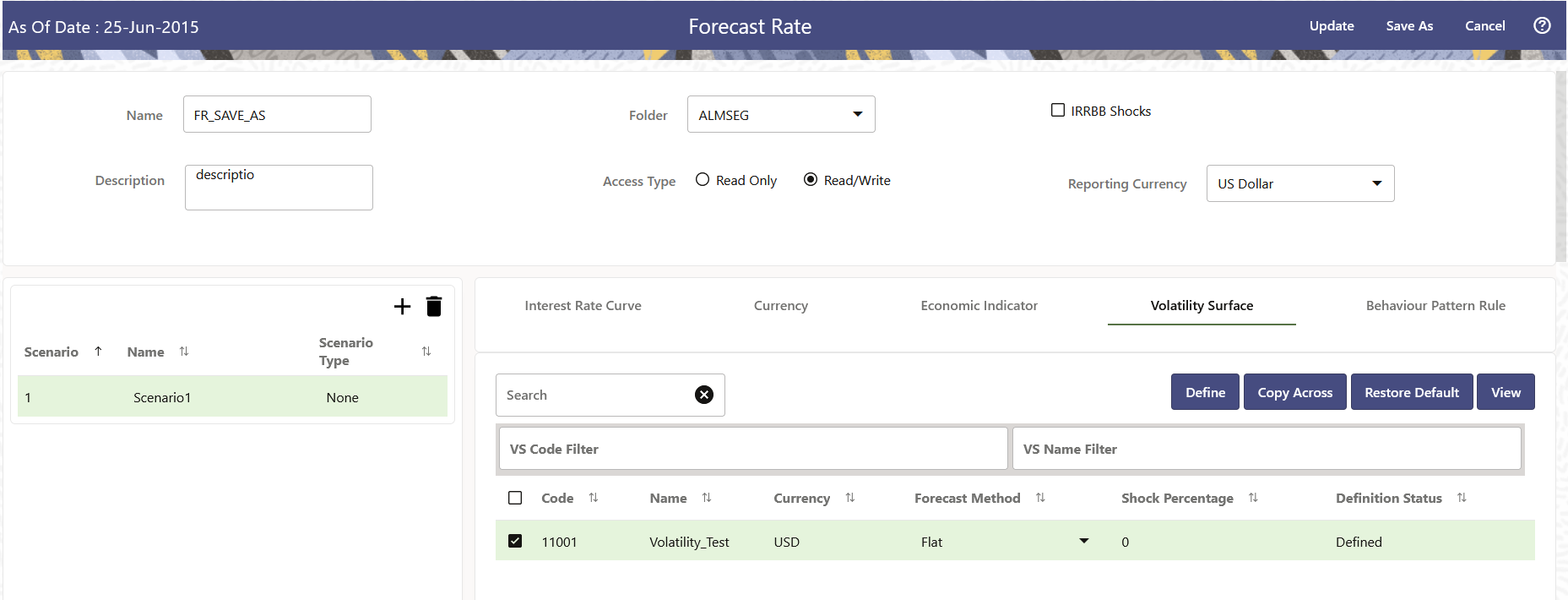

Following options are available for Volatility Surface Forecast Rule:
Define
Flat Method
- Select Volatility Surface Code using corresponding checkbox and select Forecast Method as Flat.
- Click Define.
- The status of the Volatility Surface Code is changed to Defined.
- Global Shock
- Select Volatility Surface Code using corresponding checkbox and select Forecast Method as Global Shock.
- Input Shock Percentage, if required.
- Click Define.
- Detail Shock
- Select Volatility Surface Code using corresponding checkbox and select Forecast Method as Detail Shock.
- Click Define. The Detail Shock window is displayed:
Figure 3-99 Detail Shock window
- Right click on data grid and select ‘Export to Excel’ to save visible data to excel file. You can also copy directly from the grid and paste data from an excel file to the grid. Enter data and click Apply.

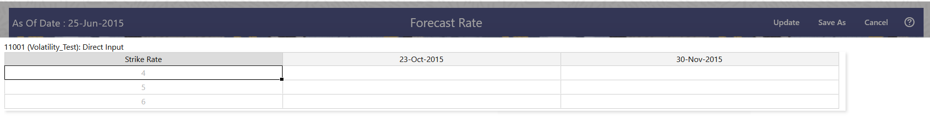

- Direct Input
- Select Volatility Surface Code using corresponding checkbox and select Forecast Method as Direct Input.
- Click Define. The Direct Input window is displayed:
Figure 3-100 Direct Input window
- Enter a shock amount to apply to the Volatility Surface. Right click on data grid and select ‘Export to Jexcel’ to save visible data to excel file. You can also copy directly from the grid and paste data from an excel file to the grid.
- Click Apply.
