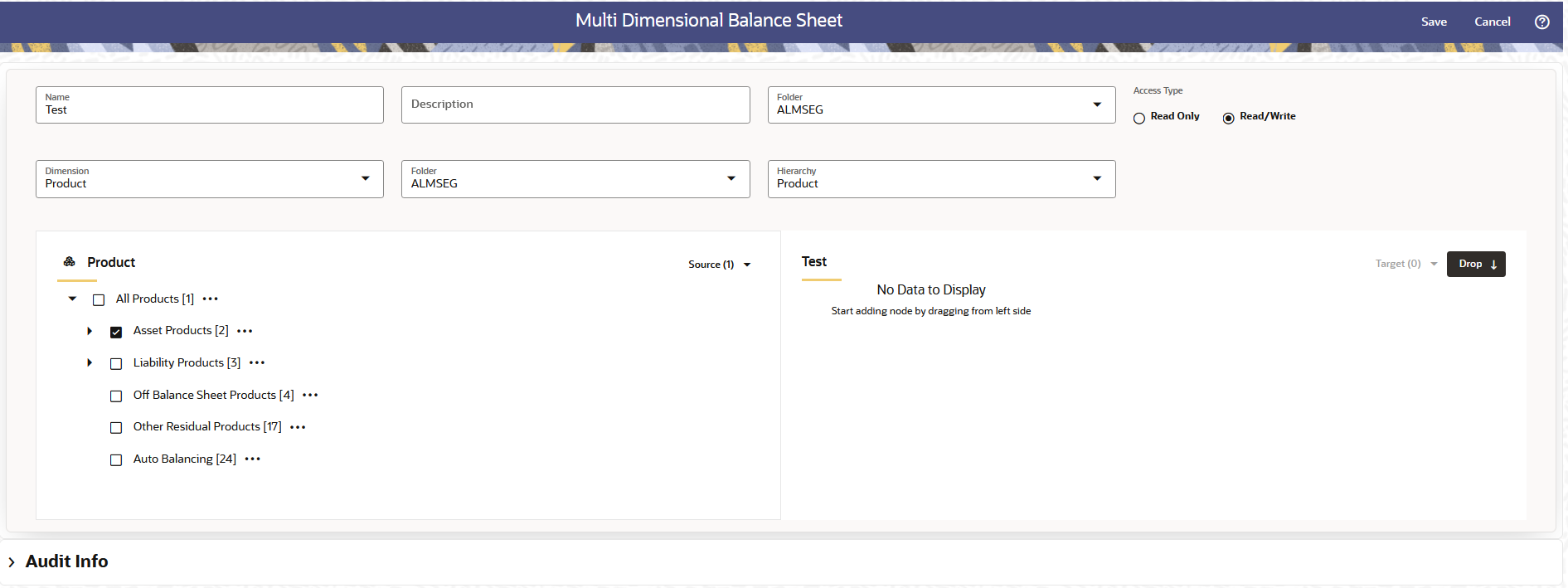

    • If Dimension is selected as “Product”, then Product Folder and Product Hierarchy fields will be available.

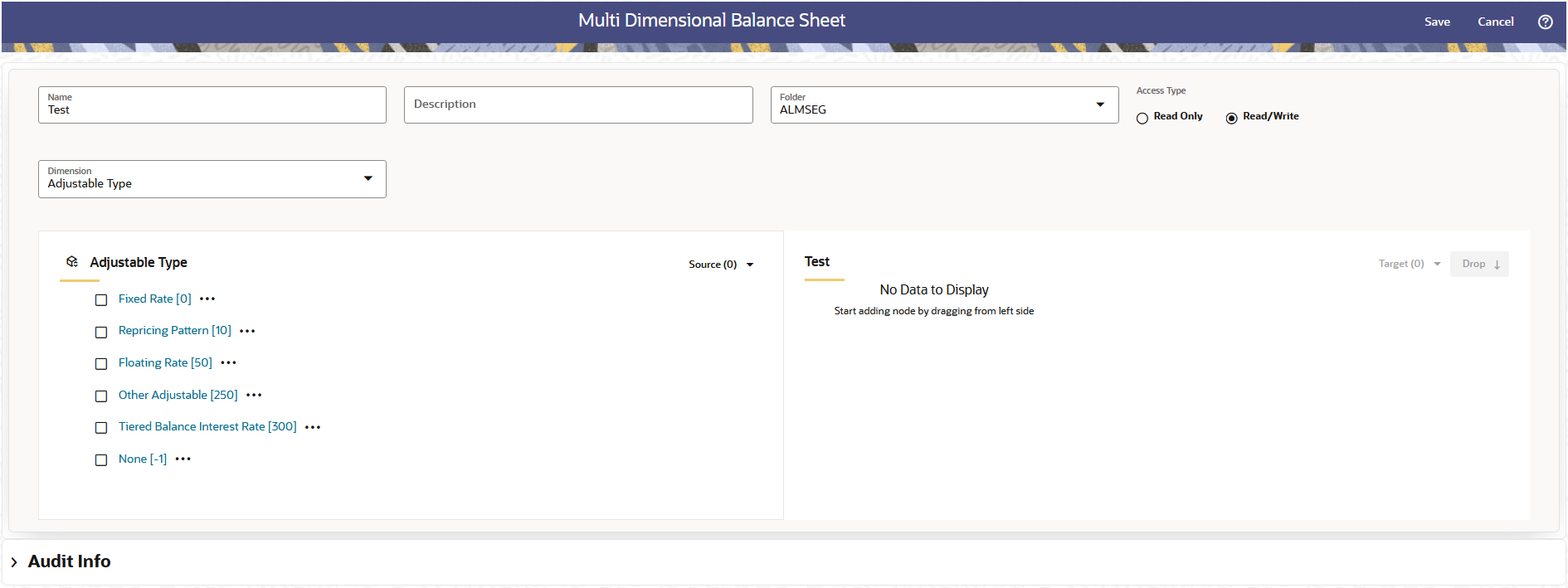

    • If Dimension is selected as “Adjustable Type”, then only list of Adjustable Types will be available.

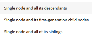

    • When you select a Node from Source section, then following options are available:
      Figure 5-16 MDBSS Rule
      MDBSS Rule
      • Single node and all its descendants: Allows to select node itself along with its descendants.
      • Single node and its first-generation child nodes: Allows to select node itself along with its child nodes
      • Single node and all of its siblings: Allows to select node itself along with its siblings nodes

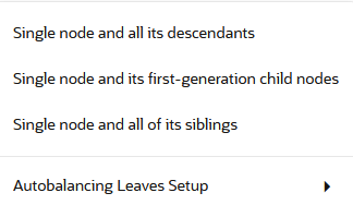

    • When node is moved to Target section, then following options are available:
      Figure 5-17 MDBSS Rule
      MDBSS Rule
      • Autobalancing Leaves Setup: Allows you to setup the Autobalancing for selected node as Asset, Liability, or Retained Earning.
