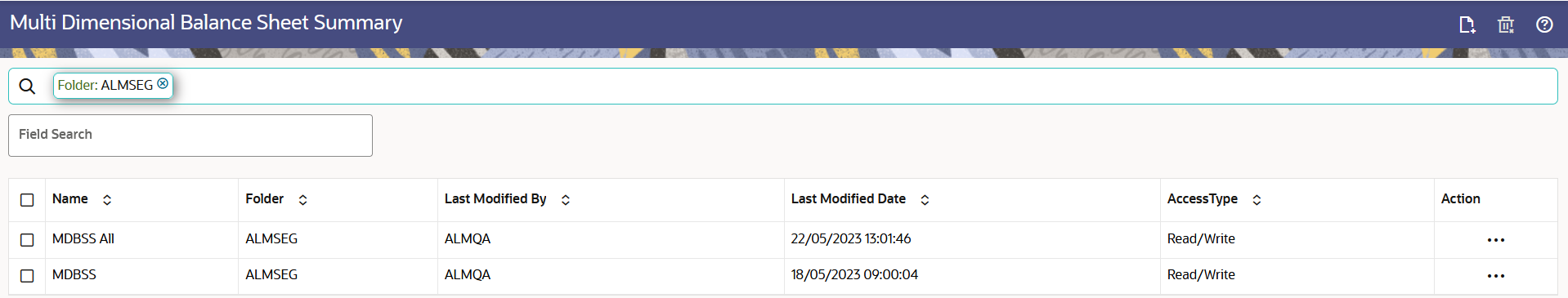

This page is the gateway to all Multi Dimensional Balance Sheet Structure Rules and related functionality. You can navigate to other pages relating to Multi Dimensional Balance Sheet Structure Rules from this point.
Figure 5-12 Multi Dimensional Balance Sheet Summary

An alternative method to search a Multi Dimensional Balance Sheet Structure Rule is through the Field Search option. This is an inline wildcard UI search that allows you to enter a search value (such as code, name, etc.) partially or fully. Rows that contain the string you are searching for are fetched and displayed in the Multi Dimensional Balance Sheet Structure Rule Summary. You can enter the Name, Description, , and Folder of the Multi Dimensional Balance Sheet Structure Rule and click Search .
The Multi Dimensional Balance Sheet Structure Rule Summary displays the following information:
Add: Click the Add icon on the page header to build a new Multi Dimensional Balance Sheet Structure Rule.
- Name: The Multi Dimensional Balance Sheet Structure Rule's short name.
- Folder: The Folder name where the Multi Dimensional Balance Sheet Structure Rule is saved.
- Last Modified By: The user who last modified the Multi Dimensional Balance Sheet Structure Rule.
- Last Modified Date: The Date and Time when the Multi Dimensional Balance Sheet Structure Rule was last modified.
- Access Type: The access type of the rule. It can be Read-Only or Read/Write.
- Action: Click this icon to view a list of
actions that you can perform on the Multi Dimensional Balance Sheet Structure
Rule.
- Multiple Delete: Enables you to select and delete one or multiple rules in the table simultaneously.
- View/Edit: Based on the user privilege assigned, you can either only view or edit existing Multi Dimensional Balance Sheet Structure Rules. To edit a rule, you must have Read/Write privilege.
- Save As: You can reuse a Multi Dimensional Balance Sheet Structure Rule by saving it under a new name thus saving time and effort in entering data multiple times; it also leads to reduced data entry errors.
- Delete: You can delete Multi Dimensional Balance Sheet Structure Rules that you no longer require. Note that only Multi Dimensional Balance Sheet Structure Rule owners and those with Read/Write privileges can delete Multi Dimensional Balance Sheet Structure Rules. A Multi Dimensional Balance Sheet Structure Rule that has a dependency cannot be deleted.
