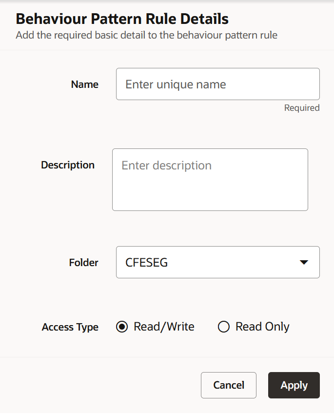

Figure 6-110 Create Behavior Pattern Rule page
- Enter the following Details.
Table 6-30 Create Behavior Pattern Rule
Fields Description Name Enter the name of the Behavior Pattern Rule. Description Enter the description of the Behavior Pattern Rule. This is an optional field. Folder Select the Folder where the Behavior Pattern Rule needs to be saved. Access Type Select the Access Type as Read-Only or Read/Write. - Click Apply. The Behavior Pattern Rule page is displayed:

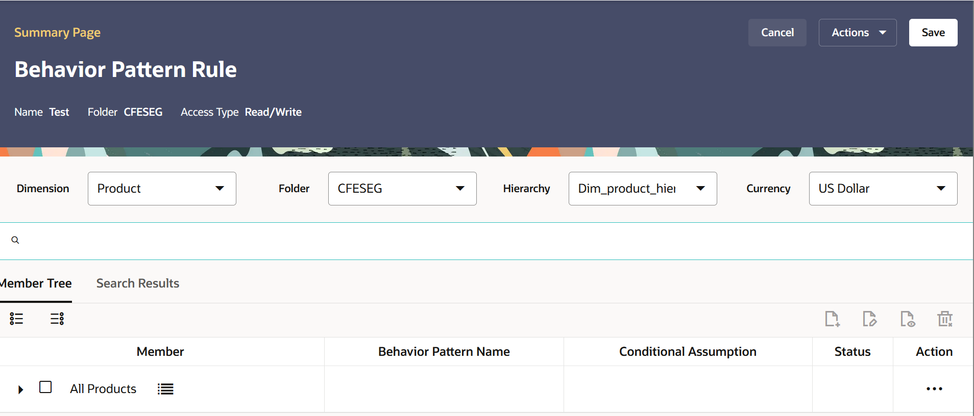

Figure 6-111 Behavior Pattern Rule Page
- Select the Dimension as Common Chart of Accounts, Product, General
Ledger Account, or MDBSS.
MDBSS is enabled only in ALM Cloud Service.If any member is a currency in the MDBSS hierarchy (for example, INR) and selected currency is different (for example USD), then the member and its children nodes cannot be defined.
You can search the rule on any of the product dimension, searched dimension will be auto-populated while defining the rule; if you like, you can change the default product dimension.
- Select a Currency.
- Select Folder and Hierarchy.
- Select Member Node(s) from Member Tree of Assumption Browser.
The Assumption Browser has following two tabs: Member Tree and Search Results

Figure 6-112 Member Tree
Status of node is also displayed in Member Tree section, for example Selected, and so on. To select member hierarchy, following options are available:
