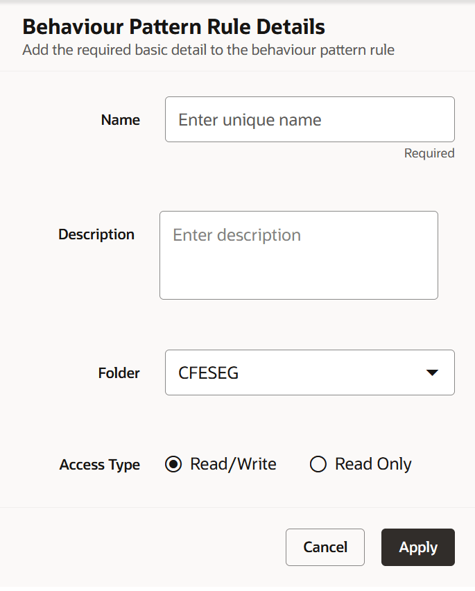

    Figure 6-110 Create Behavior Pattern Rule page
  2. Enter the following Details.
    Table 6-30 Create Behavior Pattern Rule
    Fields Description
    Name Enter the name of the Behavior Pattern Rule.
    Description Enter the description of the Behavior Pattern Rule. This is an optional field.
    Folder Select the Folder where the Behavior Pattern Rule needs to be saved.
    Access Type Select the Access Type as Read-Only or Read/Write.
  3. Click Apply. The Behavior Pattern Rule page is displayed:
