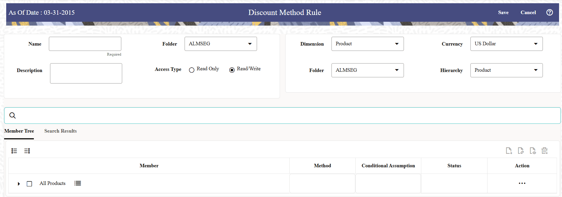

You create a Discount Methods rule to assign Discounting Methods to your products. To create a Discount Method Rule, follow these steps:
  1. Navigate to the Discount Methods Rule Summary page.
    Figure 6-126 Discount Method Rule
  2. Click Add. The Discount Method Rule page is displayed.
  3. Enter the following details:
    Table 6-32 Discount Method Details
    Fields Description
    Name Enter the name of the Discount Method Rule.
    Description Enter the description of the Discount Method Rule. This is an optional field.
    Folder Select the Folder where the Discount Method Rule needs to be saved.
    Access Type Select the Access Type as Read-Only or Read/Write.
  4. Select a Product Hierarchy. You can define methodologies at any level of the hierarchical product dimension. The hierarchical relationship between the nodes allows inheritance of methodologies from Parent Nodes to Child Nodes. Enter the following details for Product Hierarchy selection:

  5. Select the Dimension as Common Chart of Accounts, Product, General Ledger Account, or MDBSS.
    MDBSS is enabled only in ALM Cloud Service.
    If any member is a currency in the MDBSS hierarchy (for example, INR) and selected currency is different (for example USD), then the member and its children nodes cannot be defined.
    You can search the rule on any of the product dimension, searched dimension will be auto-populated while defining the rule; if you like, you can change the default product dimension.
  6. Select Member Node(s) from Member Tree of Assumption Browser. The Assumption Browser has following two tabs: Member Tree and Search Results
