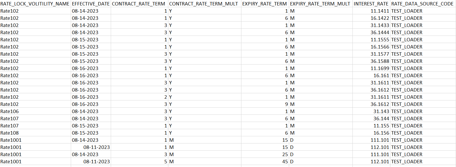

The following illustration is a sample Rate Lock Option Volatility loader data file.
Figure 4-15 Rate Lock Volatility Loader Sample File
