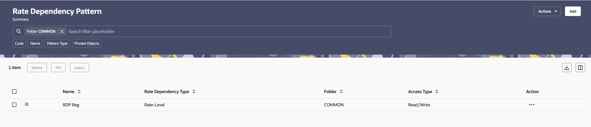

Rate Dependency Pattern Summary Page
This page is the gateway to all Rate Dependency Pattern rules and related functionality. You can navigate to other pages relating to Rate Dependency Pattern rules from this point.
Figure 6-212 Rate Dependency Pattern Summary

The Rate Dependency Pattern Summary page displays the following information:
Add: Click the Add icon on the page header to build a new Rate Dependency Pattern rule.
Actions: Enables you to perform following tasks.
  • Refresh: Retains the selected filters and refreshes the summary page with latest status.
  • Reset: Clears the selected filters and refreshes the summary page.
  • Help: Redirects you to latest documentation.
Delete: Enables you to select and delete one or multiple rules in the table simultaneously.
Pin/Unpin: Enables you to pin/unpin the selected rule.
Export: Enables you to download the summary page details in .CSV format.
Columns: Allows you to view the summary page data using a customized list of columns.
The Rate Dependency Pattern summary table displays the following columns:
  • Name:The Rate Dependency Pattern Rule's short name. You can move-over the Name to view the code and description of rule.
  • Rate Dependency Type: Type of the Rate Dependency Pattern rule.
  • Folder Name: The Folder where the Rate Dependency Pattern rule is saved.
  • Access Type: The access type of the rule. It can be Read-Only or Read/Write.
  • Action: Click this icon to view a list of actions that you can perform on the Rate Dependency Pattern rule.
    • View/Edit: Based on the user privilege assigned, you can either only view or edit existing Rate Dependency Patterns. To edit a rule, you must have Read/Write privilege.
    • Save As: You can reuse a Rate Dependency Pattern by saving it under a new name thus saving time and effort in entering data multiple times; it also leads to reduced data entry errors.
    • Delete: You can delete Rate Dependency Pattern rules that you no longer require. Note that only Rate Dependency Pattern owners and those with Read/Write privileges can delete Rate Dependency Patterns. A Rate Dependency Pattern rule that has a dependency cannot be deleted. A Rate Dependency Pattern cannot be retrieved after deletion.
    • Dependency Check: You can perform a dependency check to know where a particular Rate Dependency Pattern has been used. Before deleting a rule, it is always a good practice to do a dependency check to ensure you are not deleting Rate Dependency Pattern Rules that have dependencies. A report of all rules that utilize the selected Rate Dependency Pattern Rule is generated.
