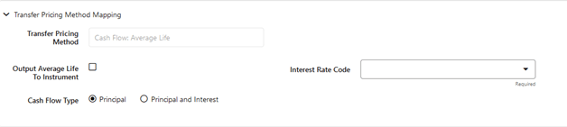

The Average Life Transfer Pricing Method provides the option to Output the result of the calculation to the Instrument Record (TP_AVERAGE_LIFE). This can be a useful option if you would like to refer to the Average Life as a reference term within an Adjustment Rule.
Users also have the choice to populate the TP_AVERAGE_LIFE column directly with a value computed outside of Oracle Funds Transfer Pricing Cloud Service. If this value is populated, the Funds Transfer Pricing Cloud Service Engine reads the TP_AVERAGE_LIFE and will look up the Funds Transfer Pricing Rate for the given term. In this case, the Transfer Pricing Engine does not generate Cash Flows and will not re-compute the Average Life. It simply uses the value that is provided and lookup the appropriate Funds Transfer Pricing Rate from the specified TP Interest Rate Curve.
