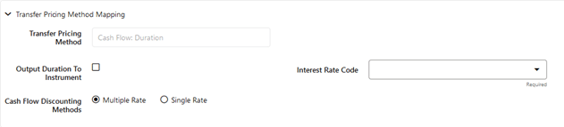

NOTE: The Duration Transfer Pricing Method provides the option to Output the result of the calculation to the instrument record (TP_DURATION). This can be a useful option if you would like to refer to the duration as a reference term within an Adjustment Rule.
Figure 6-248 Cash Flow: Duration
Cash Flow: Duration
Users also have the choice to populate the TP_DURATION column directly with a value computed outside of Oracle Funds Transfer Pricing Cloud Service. If this value is populated, the FTP engine reads the TP_DURATION and will look up the FTP Rate for the given term. In this case, the TP Engine does not generate Cash Flows and will not re-compute the DURATION. It simply uses the value that has been provided and look up the appropriate FTP Rate from the specified TP Interest Rate Curve.
