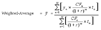

Since the goal of the Weighted Term Method is to calculate a Weighted Average Transfer Rate, it weights the transfer rate in each period, yn, by the present value for the Cash Flow of that period. Furthermore, the transfer rates are weighted by an additional component, time, to account for the length of time over which a transfer rate is applicable. The time component accounts for the relative significance of each strip Cash Flow to the total transfer pricing interest income/expense. The total transfer pricing interest income/expense on any cash flow is a product of that Cash Flow, the transfer rate, and the term. Long-term Cash Flows have a relatively larger impact on the average transfer rate. The Weighted Term method, with Discounted Cash Flow option selected, can be summarized by the following formula:
Figure 6-249 Cash Flow: Weighted Term Formula
This illustration shows the formula to calculate Cash Flow: Weighted Term.
In this formula:
  • N: Total number of payments from Start Date until the earlier of repricing or maturity
  • CFn: Cash Flow (such as Regular Principal, Prepayments, and Interest) in period n
  • r: Periodic Rate (Current Rate/Payments per year)
  • m: Remaining term to Cash Flow n/active payment frequency
  • tn: Remaining term to Cash Flow n, expressed in years
  • yn: Transfer Rate in period n

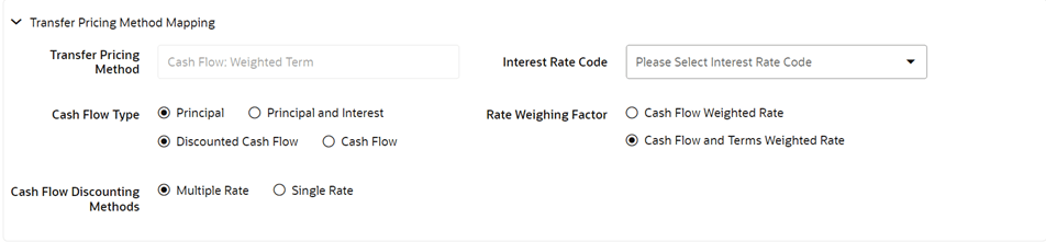

Within the Cash Flow Weighted Term method definition screen, users can select the Cash Flow type as either Principal + Interest (the default selection) or Principal Only. This selection impacts the CFn in the above formula.

For this method, the following options are also provided:
  • Cash Flow Weighted Rate
  • Cash Flow and Terms Weighted Rate (by default, this will remain selected for all existing definitions)
If Transfer Rate needs to be weighed only by Cash Flow rather than both Cash Flow and term, then Cash Flow Weighted Rate can be selected, and the system will not consider terms (tn) for calculations.
If Cash Flow and Terms Weighted Rate is selected, then both terms, as well as Cash Flow will be used for Weighing Transfer Rate as per calculations shown above.

Figure 6-251 Cash Flow: Weighted Term
