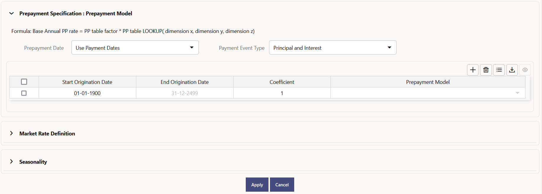

Figure 6-92 Prepayment Model Method

Use Payment Dates
  1. Select the Use Payment Dates Option.
  2. Select the Payment Event Type Option.
  3. Select the Start Origination Date using the date picker. Alternatively, you can enter the Start Origination Date in the space provided.
    The first cell in the Start Origination Date Column and all the cells in the End Origination Date Column are read-only. This ensures that all possible origination dates must support refer­ence values when Prepayment assumption lookups occur.
    Each row in the End Origination Date Column is filled in by the sys­tem when you click Add Row or save the Rule.
    The first Start Origination Date (in row 1) has a default value of January 1, 1900. When you enter a Start Origination Date in the next row, the system inserts a date that is a day before the previous End Origination Date field.
  4. Enter the Coefficient (if needed) by which the Prepayment Rate should be multiplied and select a predefined prepayment model that you want to apply to the instruments having orig­ination dates in a particular Start Origination-End Origination Date range
  5. Click Add Row to add additional rows and click the corresponding Delete Button to delete a row.
  6. You can add as many rows as possible in this table using Add Multiple Row Option. However, you need to enter relevant parameters for each new row.
  7. You can also use the Download Excel feature to export the Prepayment rate information that is displayed on screen, modify, and copy-paste it back in the grid.
  8. Define Market Rate Definition.
  9. Define the source for the Market Rate by Selecting an Index (Interest Rate Code) from the list of values.
  10. Enter the Spread. The spread is added to the rate from the underlying interest rate curve to determine the market rate.
  11. Select an Associated Term as Remaining Term, Reprice Frequency, or Original Term.
  12. Define Seasonality assumptions if required to model date-specific adjustments to the annual prepayment rate. Inputs act as a multiplier, For Example, an input of 2 will double the prepayment rate in the indicated month.
