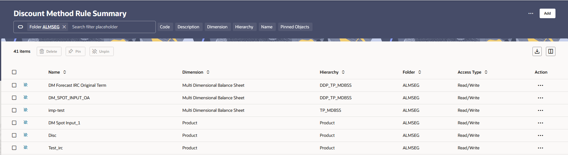

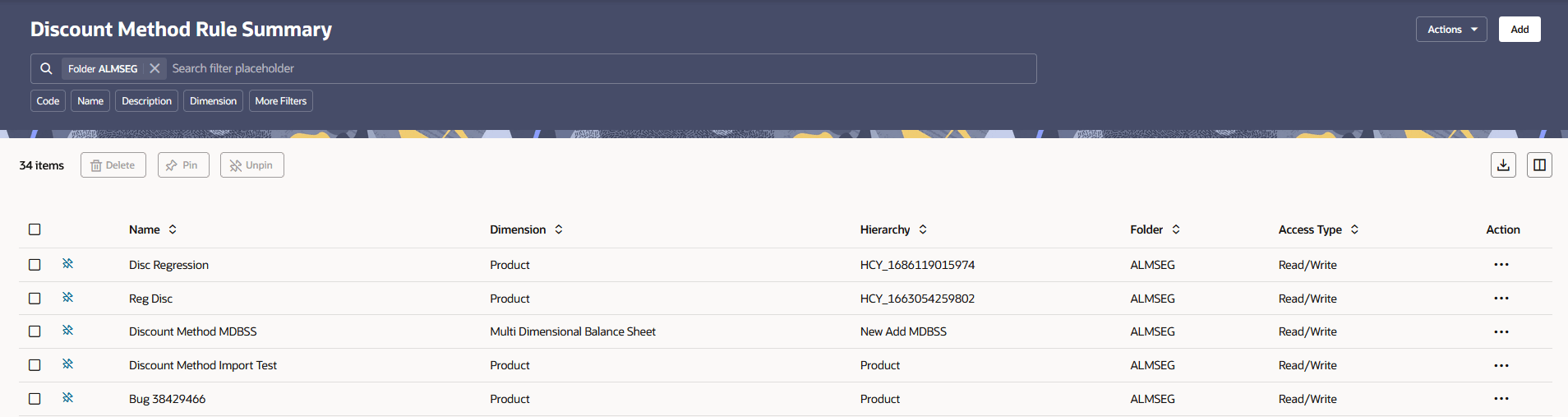

Discount Method Rule Summary
This page is the gateway to all Discount Method Rules and related functionality. You can navigate to other pages relating to Discount Method Rules from this point.
Figure 6-129 Discount Method Rule Summary
Search Discount Method Rule
Prerequisites: Predefined Discount Method Rule
To search for a Discount Method Rule:
Click Search after entering the search criteria. The search results are displayed in a table containing all the Discount Method Rules that meet the search criteria.
Or
An alternative method to search a Discount Method rule is through the Field Search option. This is an inline wildcard UI search that allows you to enter a search value (such as code, name, etc.) partially or fully. Rows that contain the string you are searching for are fetched and displayed in the Discount Method Summary. You can enter the Code, Name, Description, Dimension, Hierarchy, and Folder of the Discount Method Rule and click Search .
The Discount Method rule Summary page displays the following information:
