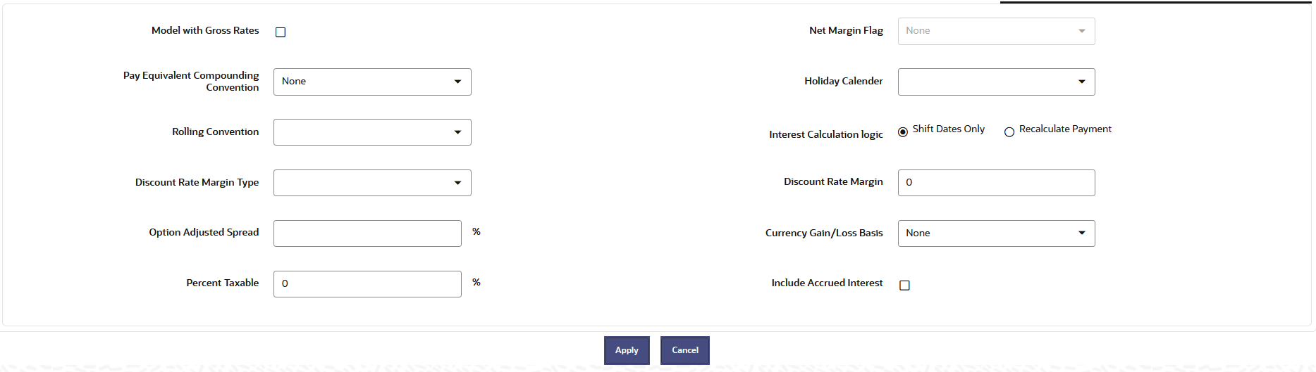

Other Attributes
The assumptions made on the Other Attributes tab apply to both current position data and new business balances.
The common Product Characteristic fields listed on the Other Attributes tab are as follows.
Figure 6-155 Other Attributes Tab to Define the Product Characteristic Rule
Table 6-42 Fields to define the attributes for Product Characteristic Rule and their Descriptions
Fields Behavior
Model with Gross Rates
