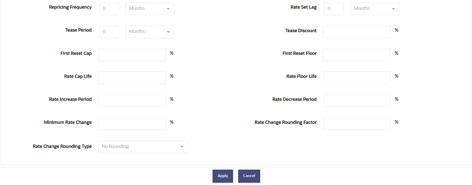

Rate Attributes
This section describes the new business fields used in the Rate Attributes secondary tab of the Product Characteristics Rule.
Figure 6-154 Rate Attributes Tab to define the Product Characteristic Rule
Table 6-41 Fields to add the Rate Attributes for Product Characteristic Rule and their Descriptions
