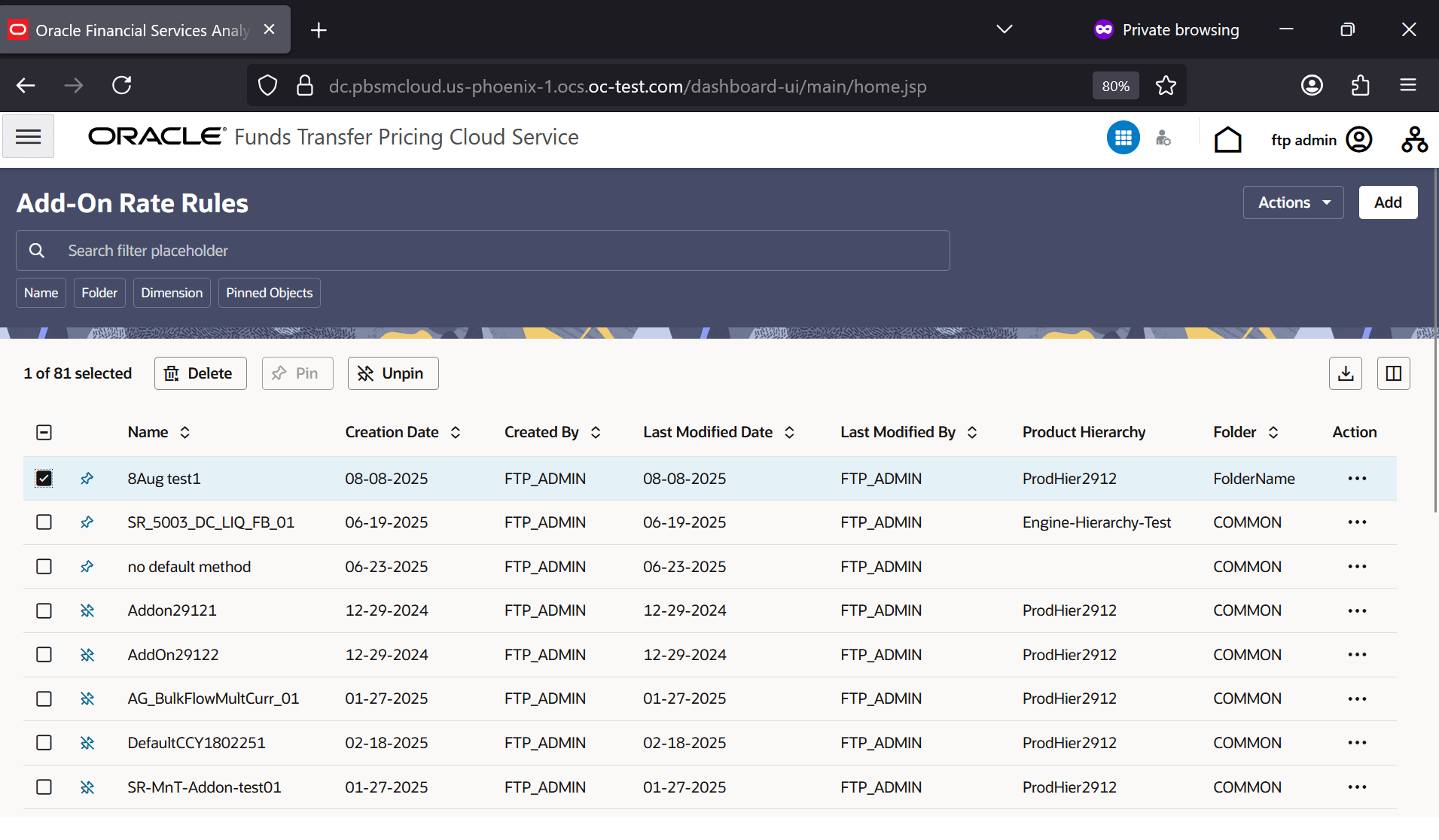

Navigating the Summary Screen
When you first navigate to the Add-on Rate Rules summary, the rules stored within your current default folder are presented in a summary table. The Add-on Rate Rules summary displays the Search pane and Add-on Rate Rule summary table.
Figure 6-275 Add-On Rates summary page
The title bar of the summary page provides several actions for the user. They are:
  • Add: Click Add icon to create a new Add-on Rate Rule.
  • Multiple Delete: Enables you to select and delete one or multiple rules in the table simultaneously.
  • Refresh: Click Refresh to reload the summary page.
  • Help: Click the Help icon to view the Add-on Rate Rules help page.
  • Pin/Unpin: Enables you to pin or unpin the selected rule.
  • Download PDF: Select one or more add-on rate rules in the table and click Download PDF to download the add-on rate rule definitions in a single PDF file or ZIP file format if multiple rule definitions are selected.

Add-on Rate Rules Summary
The Add-on Rate Rules Pane presents a table containing all Add-on Rate Rules that meet your search criteria.
The Add-on Rate Rules Summary Page displays the following columns.
  • Name: Displays name of the rule.
  • Creation Date: Displays the date and time when user created the rule.
  • Created By: Displays the Name of the user who created the rule.
  • Last Modification Date: Displays the Date and Time at which an Add-on Rate Rule was last modified.
  • Last Modified By: Displays the name of the user who last modified an Add-on Rate Rule.
  • Access Type: Displays the access type of the rule - Read/Write or Read Only property of an Add-on Rate Rules. Only the creator of a Rule may change its Access Type.
  • Folder: Displays the folder name where the Rule is stored.
  • Action: Click this icon to view a list of actions that you can perform on the rule.
    • View: Click View in the Action column and select View to view the contents of an Add-on Rate Rules in Read/Write format.
    • Edit: Click Edit in the Action column to edit the contents of an Add-on Rate Rules.
    • Delete: Click Delete in the Action column to delete an existing Add-on Rate Rule.
    • Save As: Creates a copy of the selected rule.
    • Check Dependency: Displays dependent objects associated with the rule.
    • Download PDF: Downloads the current add-on rate rule definition in a PDF file.
    You may select or deselect all the Add-on Rate Rules in the summary table by clicking the check-box in the upper left-hand corner of the summary table directly to the left of the Name Column header.
