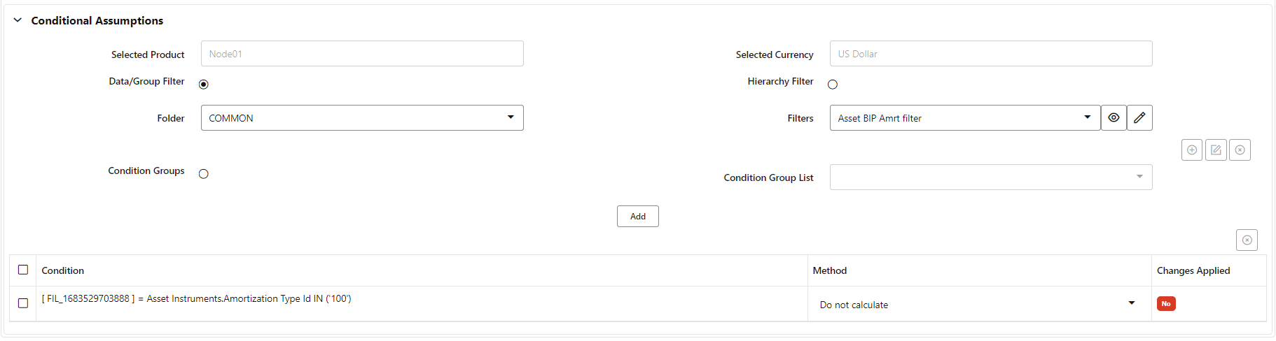

  3. Conditional Assumptions - The Conditional Assumption feature allows you to segregate your product portfolio based on common characteristics, such as Term to Maturity, Origination Date, and Repricing Frequency, and assign specific Add-on Rate Methodologies to each of the groupings.
    Figure 6-278 Conditional Assumption
    The Filters field displays the View and Edit buttons. You can verify the existing Filters by clicking the View button. Click the Edit button if you want to modify the Filter condition.
    If an instrument record does not meet any of the conditions, then the rule logic reverts to the Standard Assumption that is directly assigned to the Product/Currency combination.
