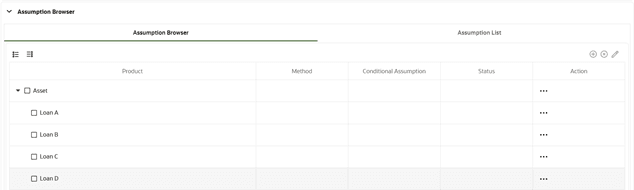

  1. Navigate to the Add-On rate Assumption Browser page.
    Figure 6-279 Add-on Rate Rule Assumption Browser
  2. Select an appropriate Add-On Rate Type: Liquidity Rate, Basis Risk Costs, Pricing Incentives, Other Add-On Rates, or Breakage Charge by opening the Add-On Rate Type Selector Window. You can enable one or more Add-on Rate Types within a single Add-on Rate Rule and apply more than one Add-on Rate to a single product.
    The Product Hierarchy refreshes when you change your Add-on Rate Type selection, but note that all selections made within the Rule are saved. For example, when Liquidity Rate is selected, the Hierarchy displays the status of Liquidity Rate mappings within the Hierarchy. If you change your Add-on Rate Type selection to Basis Risk Cost, the Hierarchy will refresh and you will see the status of all Basis Risk Cost mappings, and so on.
  3. Select a Product Hierarchy. Based on the selected Hierarchy, the application displays a list of all the products (for which you can define Assumptions).
  4. Specify a Currency from list of active currencies.
  5. Select the check-box for one or more products for which you want to define Add-on Rate Method details.
  6. Select an Add-on Rate Method and enter the appropriate parameters.
    The Add-on Rate Methods available depends on the Selected Add-on Rate Type. Depending on the Add-on Rate Type and Add-on Rate Method combinations selected, certain required and optional parameter fields are displayed. You can update these fields as required.
  7. Click Apply. If only one product was selected, the Assumption Browser Page is displayed. If more than one product was selected on the Assumption Browser Page, then each subsequent product in the select list will appear in the Selected Product drop-down list and each item should be defined appropriately. After completing the Assumption Details for each selected product, the Assumption Browser Page is displayed. At this point you can:
    1. Continue defining Assumptions for additional Product-Currency combinations for the selected Add-on Rate Type, by repeating the above procedure.
    2. Select a new Add-on Rate Type and continue defining Assumption Details for the required set of products.
    3. Complete the process by clicking Save. The new assumptions are saved, and the Add-on Rate Rule Summary page is displayed.
