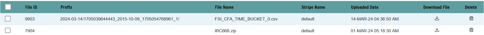

    After the batch is completed successfully, navigate to Data Management Tools, select the Data File Administration, and then select File Upload and Download. Download the exported file from object store.
    Figure 4-107 ALMCS Output Export
    ALMCS Output Export
    If you want to execute more than 10000 records, then part files are created with a suffix number such as _1, _2 and so on and will be added to Name of these files.
    The File Name Column shows the name of file with Part number. The Prefix is displayed as a combination of As of Date, Process ID and Run execution ID.
