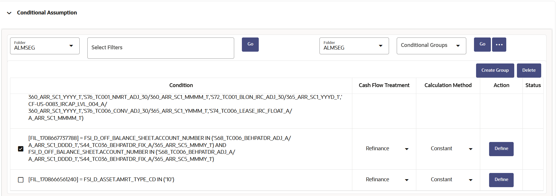

  1. Navigate to Conditional Assumptions section.
    Figure 6-95 Conditional Assumption
    Figure 6-96 Conditional Assumption
  2. Select the Filter Folder and Filter, then click Go. The condition is displayed based on selected filter.
  3. Here, you can select either group of conditions using Conditional Group or Individual condition using the filter section.

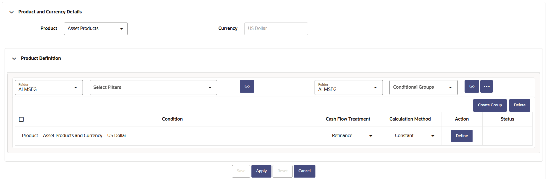

  4. Select Cash Flow Treatment as Curtailment or Refinance.
  5. Select Calculation Method as Constant, Prepayment Model, PSA, or Arctangent..
  6. Click Define.

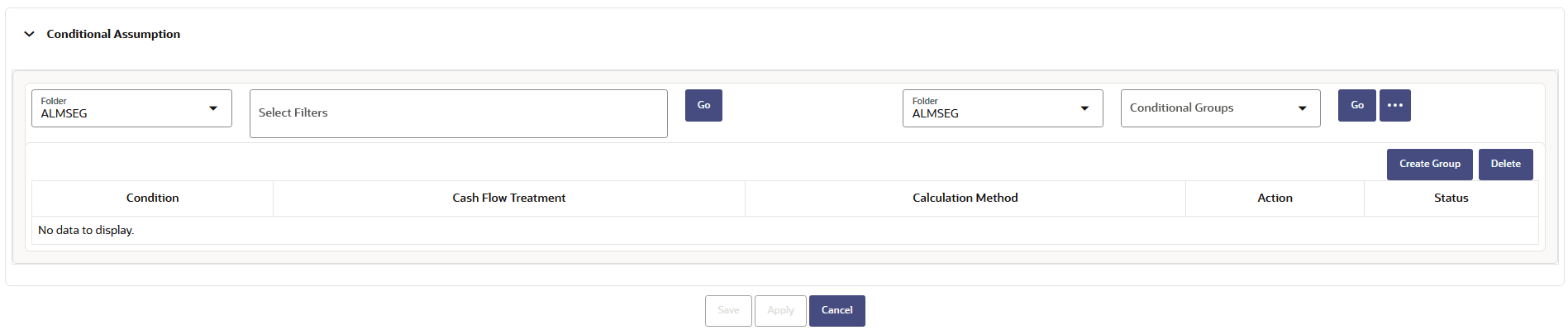

    Figure 6-97 Conditional Assumption
    Use Delete button to delete the defined condition(s)

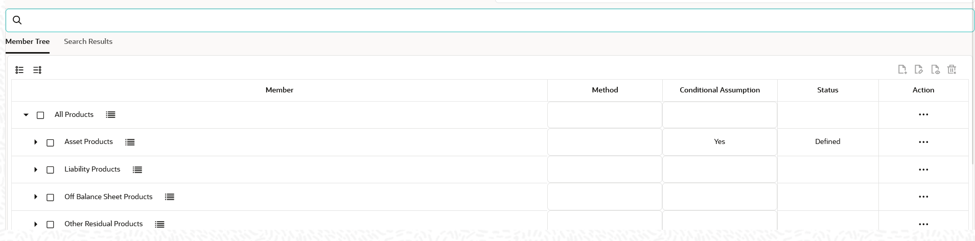

  7. Define Prepayment rule and Seasonality, and then click Apply. The status of condition assumption is updated as Defined.
    You can edit the condition using Edit.
  8. Click Save. The status of conditional assumption is also updated in Assumption Browser.

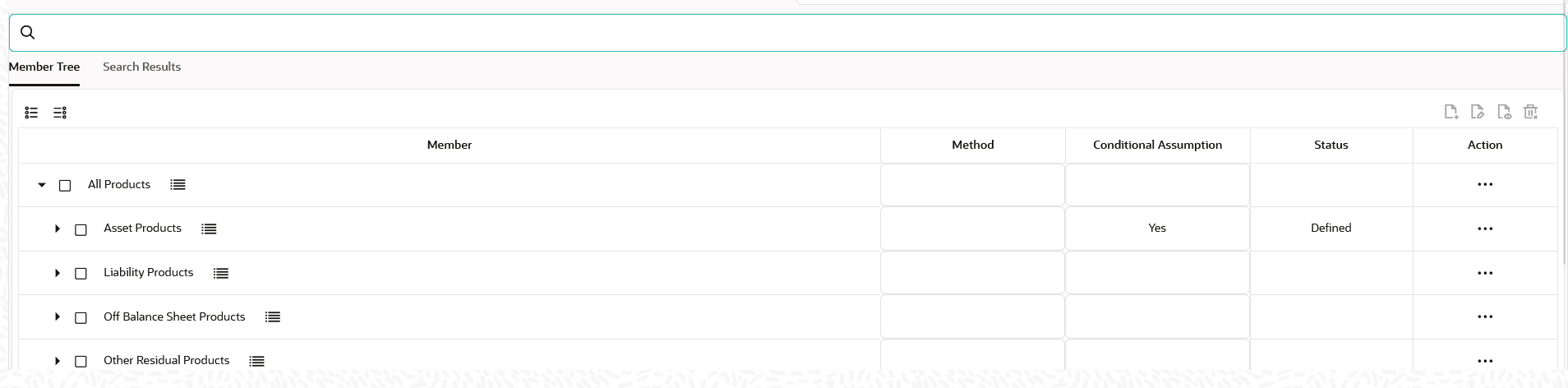

    Figure 6-98 Status of Conditional Assumption
