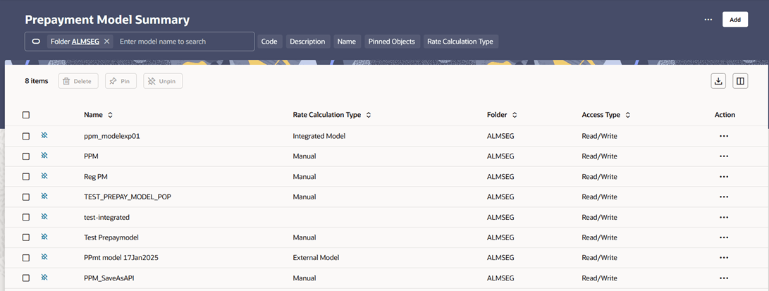

Figure 6-99 Prepayment Model Summary

The Prepayment Model rule Summary displays the following information:
Add: Click the Add icon on the page header to build a new Prepayment Model rule.
More Actions: Enables you to perform following tasks.
  • Refresh: Retains the selected filters and refreshes the summary page with latest status.
  • Reset: Clears the selected filters and refreshes the summary page.
  • Help: Redirects you to latest documentation.
Delete:Enables you to select and delete one or multiple rules in the table simultaneously.
Pin/Unpin: Enables you to pin/unpin the selected rule.
Export: Enables you to download the summary page details in .CSV format.
Columns: Allows you to view the summary page data using a customized list of columns.
The Prepayment Model rule Summary table displays the following information:
  • Name: The Prepayment Model Rule's short name.
  • Rate Calculation Type: The Prepayment Model type, such as Manual .
  • Folder: The Folder where the Prepayment Model Rule is saved.
  • Last Modified By: The user who last modified the Prepayment Model rule.
  • Last Modified Date: The Date and Time when the Prepayment Model rule was last modified.
  • Access Type: The access type of the rule. It can be Read-Only or Read/Write.
  • Action: Click this icon to view a list of actions that you can perform on the Prepayment Model rule.
    • View/Edit: Based on the user privilege assigned, you can either only view or edit existing Prepayment Model rules. To edit a rule, you must have Read/Write privilege.
    • Save As: You can reuse a Prepayment Model rule by saving it under a new name thus saving time and effort in entering data multiple times; it also leads to reduced data entry errors.
    • Delete: You can delete Prepayment Model rules that you no longer require. Note that only Prepayment Model rule owners and those with Read/Write privileges can delete Prepayment Model rules. A Prepayment Model rule that has a dependency cannot be deleted. A rule cannot be retrieved after deletion.
    • Dependency Check: You can perform a dependency check to know where a particular Prepayment Model rule has been used. Before deleting a rule, it is always a good practice to do a dependency check to ensure you are not deleting Prepayment Model rules that have dependencies. A report of all rules that utilize the selected Prepayment Model rule is generated.
