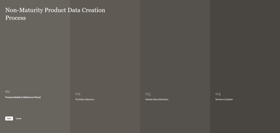

Step 1: Process Details and Reference Period
  1. From Non Maturity Data Creation Process tab, click Start. The Process Details and Reference Period page is displayed.

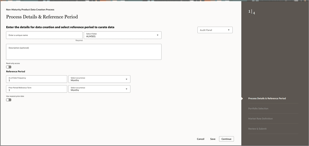

    Figure 6-360 Process Details and Reference Period
  2. Enter the following details:
    • Name: Name of Process. The Data Creation Process Name should be unique. Any special characters are not applicable.
    • Folder: Folder Name where you want to save the process.
    • Description: Description of Process. The maximum limit of this field is 300 characters. You can enter special characters in this field.
    • As of Date Frequency: The Default value of this field is 1 month. As of Date Frequency is provided to select any value in days, months, or years. Starting from Prior Period date, the data snaps will be taken at defined snap frequency till As of Date. For each date, EOD balance (CUR_PAR_BAL) for the account on Data Snap Date, Account Origination Date (which will be required to calculate account age/vintage at each Data Snap Date), and Deposit Rate (CUR_NET_RATE) will be captured, along with market rate as per the index selected.
    • Prior Period Reference Term: The Default value of this field is 1 year. As per the prior period reference term, the prior period date is auto calculated.
  3. Click Continue.

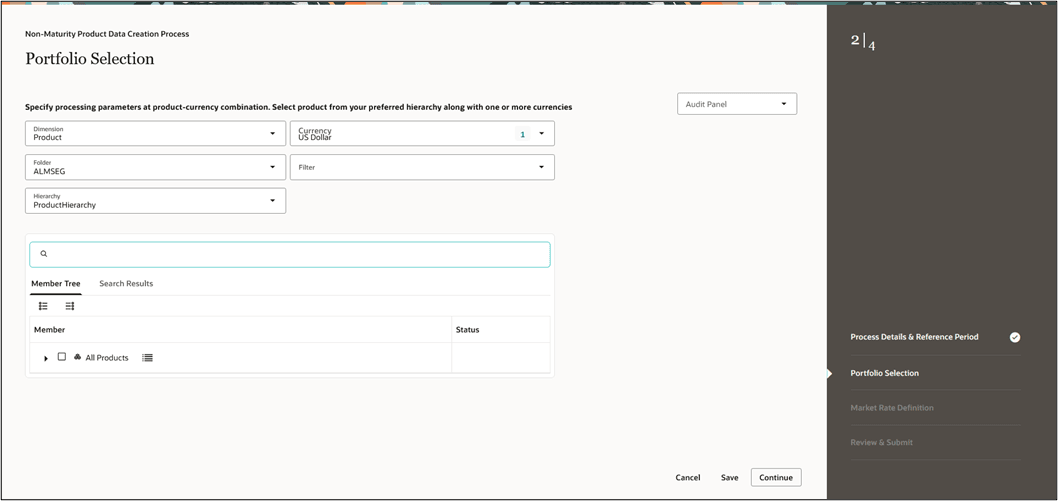

    Figure 6-361 Portfolio Selection
    Portfolio Selection
    • Dimension:Select the Dimension.
    • Currency: Select the Currency. The Currency drop-down displays the list of active currencies.
    • Folder: Select the Folder from which you want to pick the Hierarchy.
    • Filter: Select the Filter.
    • Hierarchy: You can specify some processing parameters at product-currency combination. Hierarchies in selected Folder will be listed and you can select one from the available list of hierarchies.
    • Select Product(s) from Member Tree of Assumption Browser. The Assumption Browser has following two tabs: Member Tree and Search Results
      • Member Tree: Member Tree tab shows the hierarchical structure and allows you to define rules by selecting the node members from the browser. Select Node and Click Menu icon next to it to view the available options.

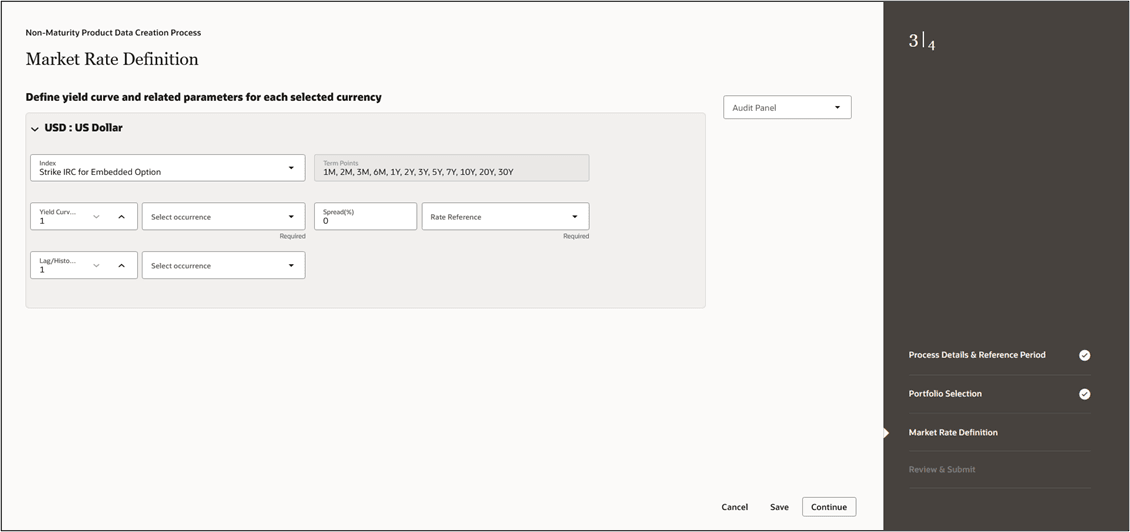

    Figure 6-365 Market Rate Definition
    • Index: As per the selected currency from the drop-down, all the interest rate curves defined will be given for selection.
    • Term Points: Shows the term points.
    • Yield Curve Term: As per the selected interest rate curve, you can select one term point. Rate corresponding to the selected term point will be picked. For intermediate term points, interpolation is done.
    • Spread: Default value is 0. This field accepts all positive, negative integers/decimals (in the range of -100% to +100%). You can enter the spread in percentage format. Enter the spread in percentage on top of rate picked from selected IRC and term point.
    • Rate Reference: Rates will be picked based on the following options:
      • As of Date: Effective Date is same as As of Date
      • As of Date with Lag: Effective date is As of Date minus some lag. If you select Rate on (As of Date- Lag), then Lag Term field will be enabled to enter term and tenor.
      • Average of Historical Term : The effective date is not a single date but a period starting from the As of Date, during which an arithmetic average is calculated to smooth out any interest rate fluctuations. If you select Average of Historical Term (As of Date), the Historical Term field will be enabled for you to input the term and tenor.
    • Lag/Historical Term: Refers to the period used for calculating averages or trends in data.
