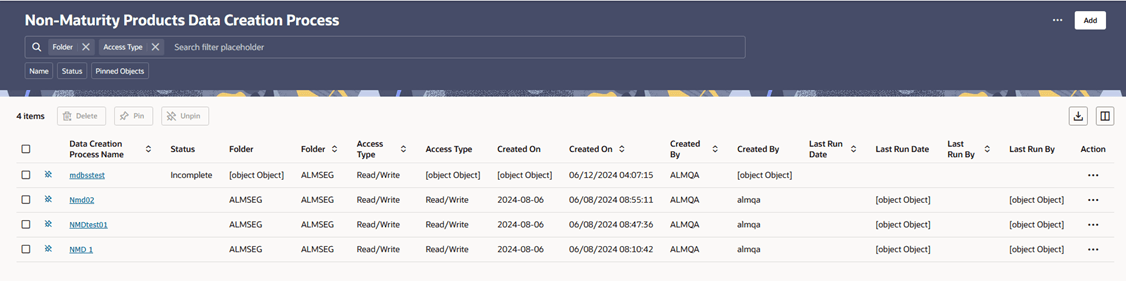

Data Creation Process Summary
This page is the gateway to all Data Creation processes and related functionality. You can navigate to other pages relating to Data Creation processes from this point.
Figure 6-358 Data Creation Process Summary Page
Search Data Creation Process
Prerequisites: Predefined Data Creation Process
To search for a Data Creation Process, follow these steps:
Click Search after entering the search criteria. The search results are displayed in a table containing all the Data Creation Processes that meet the search criteria.
Or
The other method to search a Data Creation Process is using the Field Search option. The Field Search is an inline wildcard UI search that allows you to enter value partially or fully and the rows that match the entered string in any of its column is fetched in the Summary table. Enter the Name, Status, Folder, or Access Type status of the Data Creation Process and click Search.
The Data Creation Process summary page displays the following:
Add: Click the Add on the page header to build a new Data Creation process.
More Actions: Enables you to perform following tasks:
  • Refresh: Retains the selected filters and refreshes the summary page with latest status.
  • Reset: Clears the selected filters and refreshes the summary page.
  • Help: Redirects you to latest documentation.
Delete: Enables you to select and delete one or multiple rules in the table simultaneously.
Pin/Unpin: Enables you to pin or unpin the selected rule
Export: Allows you to download the summary page details in .cs format.
Columns: Enables you to customize the list of columns.
The Data Creation Process summary table displays the following columns:
  • Data Creation Process Name: Name of the Data Creation Process's short name.
  • Status: Status of the Data Creation Process.
  • Folder: The folder where the Data Creation process is saved.
  • Access Type: The access type of the rule. It can be Read-Only or Read/Write.
  • Created On: The Date and Time when the Data Creation process was created.
  • Created By: The user who created the Data Creation process.
  • Last Run By: The user who last run the Data Creation process.
  • Last Run Date: The Date and Time when the Data Creation process was last modified.
  • Action: Click this icon to view a list of actions that you can perform on the Data Creation process.
    • View/Edit: Based on the user privilege assigned, you can either only view or edit existing Data Creation processes. To edit a rule, you must have Read/Write privilege.
    • Save As: You can reuse a Data Creation process by saving it under a new name thus saving time and effort in entering data multiple times; it also leads to reduced data entry errors.
    • Delete: You can delete Data Creation processes that you no longer require. Note that only Data Creation process owners and those with Read/Write privileges can delete Data Creation processes. A Data Creation process that has a dependency cannot be deleted. A rule cannot be retrieved after deletion.
    • Execute: Select Execute to execute an existing Data Creation process. After clicking Execute, the Execute window is displayed. Select As of Date (Execution Date), and then click Submit.
    • View Execute Details: Select Execute Details to view execution details of the Data Creation process. Click Execution ID link to view detailed information of process execution.
