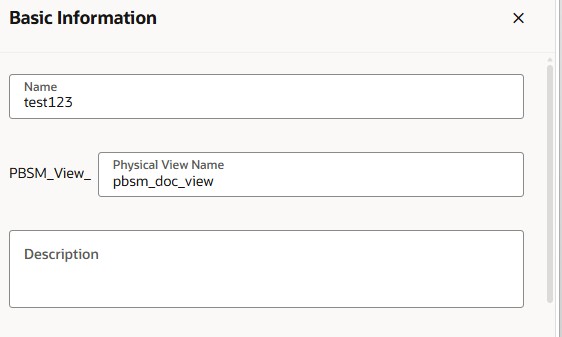

  3. Enter the following details in the Basic Information panel:
    • Name : Enter a unique, logical name for the view (for example, test123).
    • Physical View Name : Enter the physical view name. The prefix PBSM_View_ is applied automatically; you only need to enter the remaining suffix (for example, entering pbsm_doc_view results in the physical view name PBSM_View_pbsm_doc_view).
    • Description : Optionally enter a brief description of the view.
    Figure 5-49 Basic Information panel

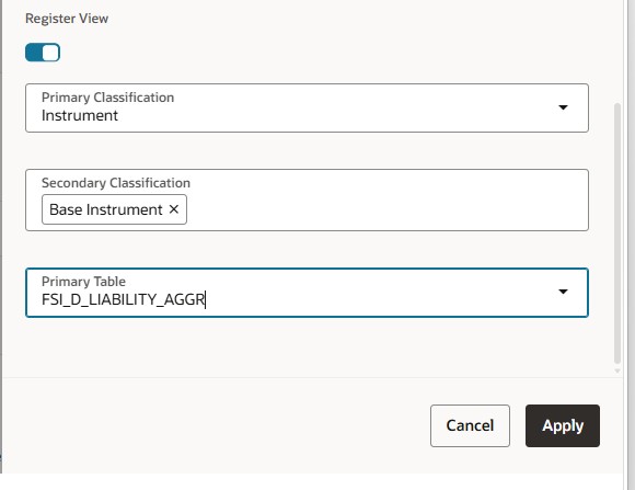

  4. Enable the Register View toggle if this view should be classified and made available for selection as a source in consuming modules.
    Register View is the trigger for classification-based behavior. Only when Register View is enabled does the Primary Classification field appear, and only then is the view's classification code (and the associated table UDP → view UDP mapping) applied.
  5. With Register View enabled, select the Primary Classification from the dropdown. T
    he available values are: Instrument , Management Ledger , Portfolio , and Transaction Summary .
  6. Select the Primary Table from the dropdown. The list of tables is filtered based on the Primary Classification selected in the previous step (for example, selecting Instrument populates tables such as FSI_D_LIABILITY_AGGR).
  7. Click Apply to confirm the Basic Information and primary table selection, or Cancel to discard your entries and close the panel.
    Figure 5-50 Register View
    Register View
