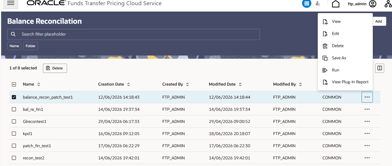

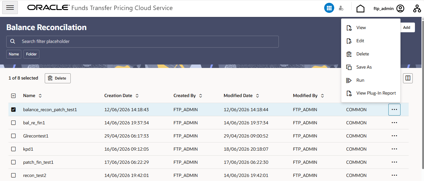

The following screen display the Actions menu from which the different actions that you can perform on existing Reconciliation Definitions.
Figure 4-55 Actions Icon and Different Actions
The following are the actions:
  • View: Click this action button and view the definition in read only format.
  • Edit: Click this action button and edit the definition.
  • Delete: Click this action to delete the selected definition.
  • Save As: Click this action to create a new definition by copying the selected definition.
  • Run: Click this action to execute the reconciliation based on the selected parameters.
    As-of-Date is a run time parameter, you can choose for which date reconciliation needs to be performed.
  • View Plug-In-Report: Click this action to view the generated Reconciliation Report for the selected run.
  • Execution Details: Click this action to view all the runs for a selected definition, along with the user information of who triggered the execution.
    The View Plug-In-Report option displays the generated Plug-In-Report for the selected reconciliation run.

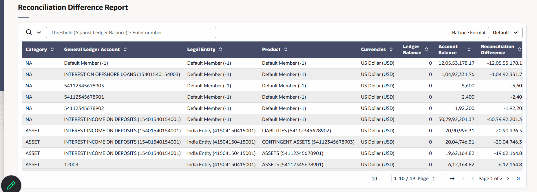

    The detailed report is displayed as follows, where you can filter out insignificant difference using ‘Threshold Percentage’, also threshold can be applied at each row level or for whole Balance Sheet category level. If threshold is applied at Balance Sheet category level, all the rows that belong to the Balance Sheet category which is less than given percentage will be hidden from the Reconciliation Difference Report. A download button allows you to download the Reconciliation Report.
    You can select Filter at Category Level toggle switch to apply threshold at ‘consolidated difference reports’, which is at balance sheet category level OR can directly apply the threshold to each difference row, which is available at the unique combination of selected key dimensions.
    You can select the ID / Code toggle switch to see the CD data. By default, the toggle switch displays the ID data.

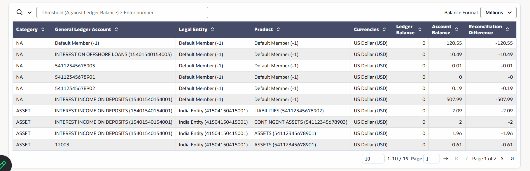

    You can also change the unit of balance to thousands or millions.
    You can see difference in both percentage and absolute format.

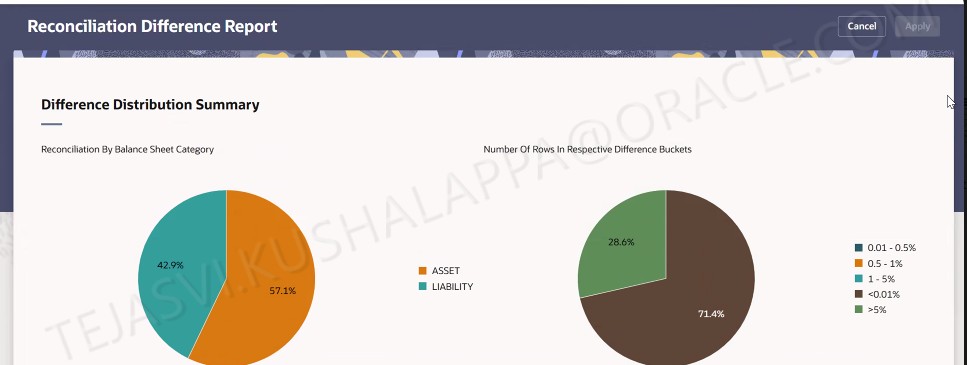

    The Apply button is disabled. When the button is disabled, plug entries cannot be created from the Difference Report. Use Cancel to close the report without creating plug entries.
    Plug entries can only be created through batch processing. Use the Difference Report UI only to review and verify unaccounted balances; plug entries cannot be created from this UI.

  1. Navigate to the Balance Reconciliation Summary screen.
  2. Select the completed Balance Reconciliation definition or run for which you want to view the report.
  3. Click the Action menu icon for the selected row.
  4. Select View Plug-In Report.

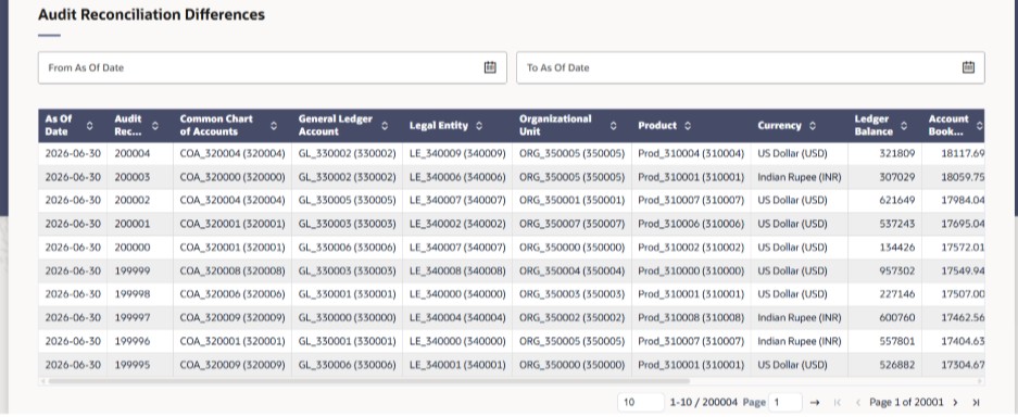

    The GL Recon Audit page is displayed.
  5. Enter or select the required From As Of Date and To As Of Date.
  6. Click Apply.
    The report displays the audit reconciliation differences for the selected period, including details such as As Of Date, Common Chart of Accounts, General Ledger Account, Ledger Balance, Account Book Balance, Account Par Balance, Reconciliation Difference, and percentage difference values.
