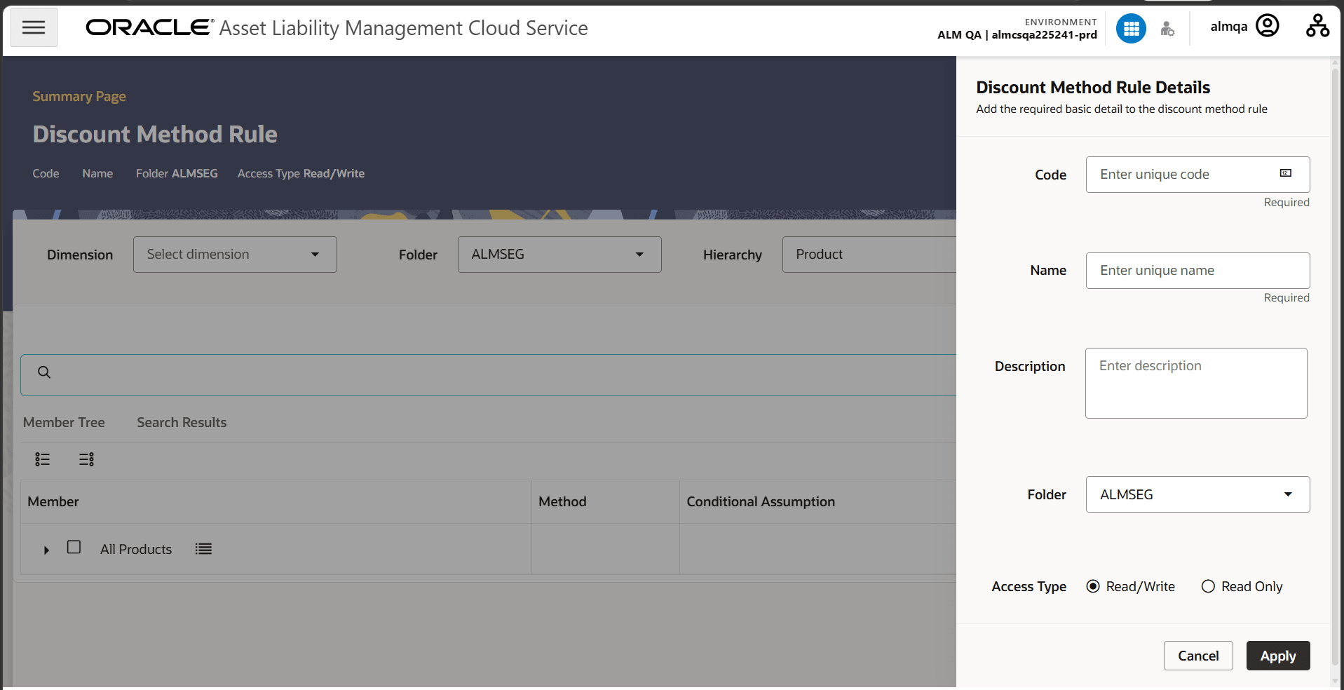

  2. Click Add. The Discount Method Rule page is displayed.
  3. Enter the following details:
    Table 7-32 Discount Method Details
    Fields Description
    Code Enter the code manually, or click Autogenerate to generate it automatically.
    Name Enter the name of the Discount Method Rule.
    Description Enter the description of the Discount Method Rule. This is an optional field.
    Folder Select the Folder where the Discount Method Rule needs to be saved.
    Access Type Select the Access Type as Read-Only or Read/Write.
    The Discount Method Rule definition window is displayed.

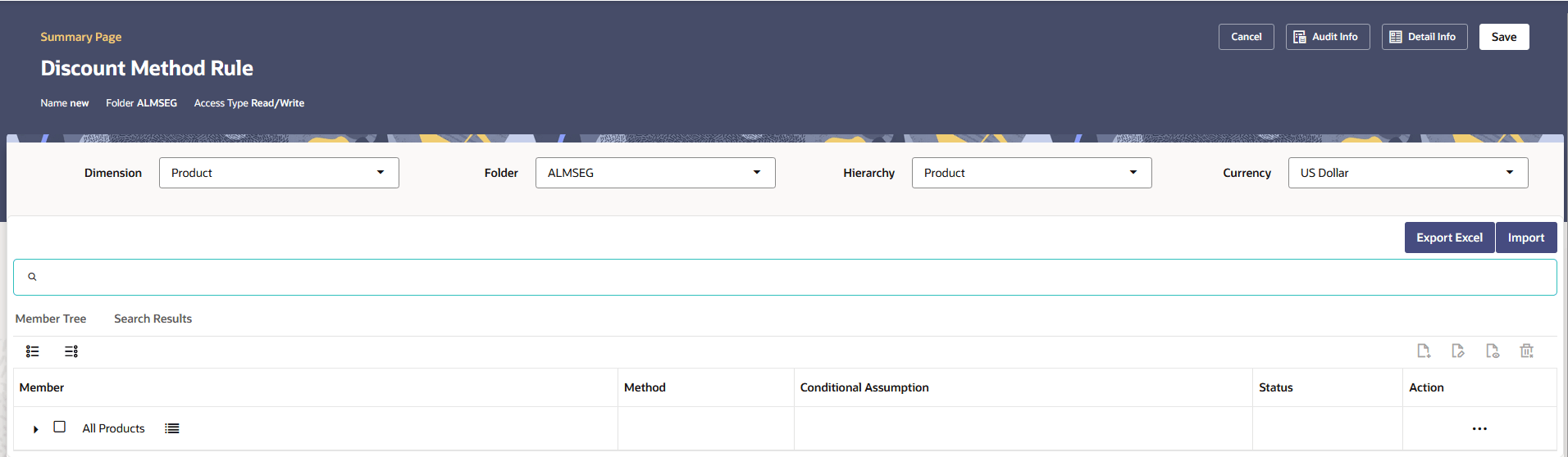

    Figure 7-131 Discount Method Rule
    Click Save button to save the draft of Discount Method rule.
    The Detail Info shows the basic details of rule, such as, Discount Method rule Name. Description, Folder Name, and Access Type.

  4. Select a Product Hierarchy. You can define methodologies at any level of the hierarchical product dimension. The hierarchical relationship between the nodes allows inheritance of methodologies from Parent Nodes to Child Nodes. Enter the following details for Product Hierarchy selection:
    Table 7-33 Product Hierarchy Details section
    Fields Description
    Folder Select the Folder where Product Hierarchy is previously created
    Hierarchy Select the Hierarchy of the product
    Currency Select the Currency.
  5. Select the Dimension as Common Chart of Accounts, Product, General Ledger Account, or MDBSS.
    MDBSS is enabled only in ALM Cloud Service.
    If any member is a currency in the MDBSS hierarchy (for example, INR) and selected currency is different (for example USD), then the member and its children nodes cannot be defined.
    You can search the rule on any of the product dimension, searched dimension will be auto-populated while defining the rule; if you like, you can change the default product dimension.
