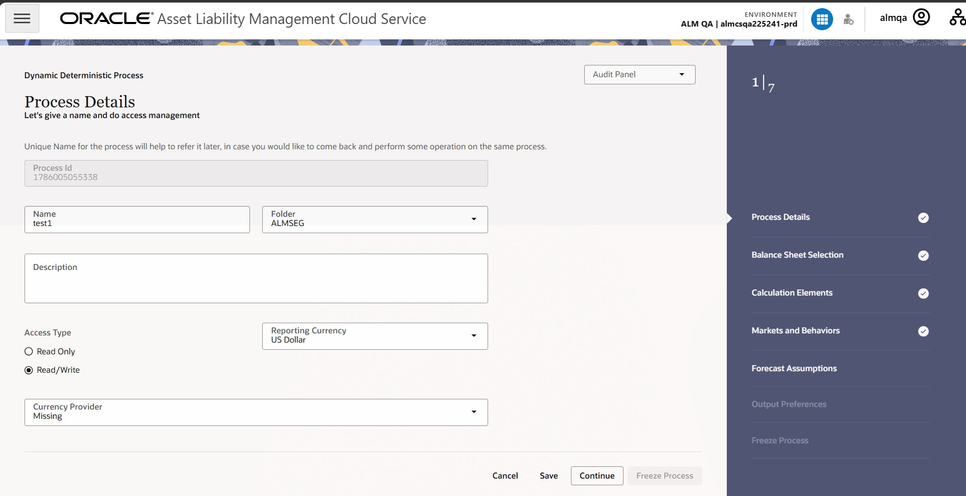

  1. Navigate to the Dynamic Deterministic Process Summary page.
  2. Click Add . The Create Dynamic Deterministic Process page is displayed.
  3. Enter the details in the Process Details section.
    Figure 7-317 Process Details
    Process Details
    Table 7-94 List of process details used for Creating Dynamic Deterministic Process
    Parameter Description
    Process ID(Code) Enter the Process ID manually, or click Autogenerate to generate it automatically.
    Name Enter the name of the Dynamic Deterministic Process.
    Folder Select the Folder where the Dynamic Deterministic Process needs to be saved.
    Description Enter the description of the Dynamic Deterministic Process.
    Access Type Select the Access Type as Read Only or Read/Write.
    Reporting Currency Select the currency for consolidation of results
    Currency Provider This field will be active once you select Reporting Currency. Select the Currency Provider as Default.

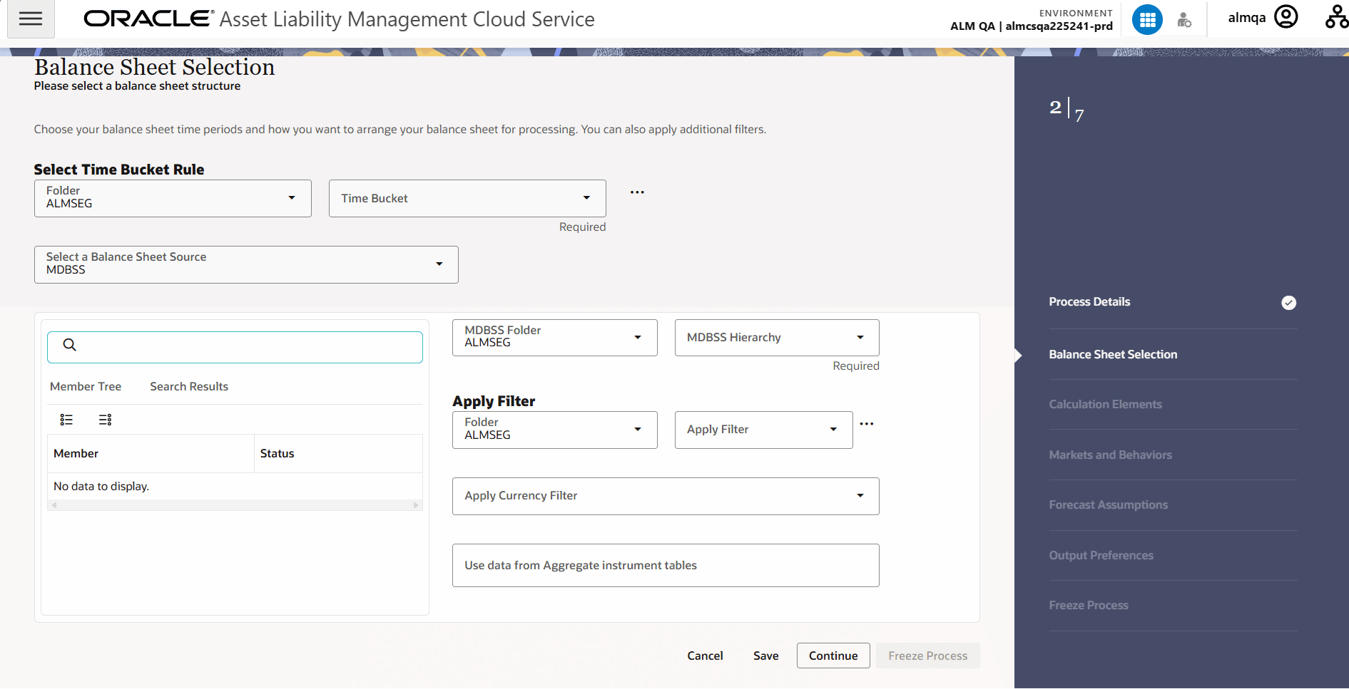

  4. Click Continue to navigate to the Balance Sheet Selection section.
    Figure 7-318 Balance Sheet Selection
  5. Enter the Balance Sheet Structure details as shown in the following table:

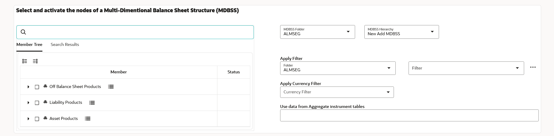

    Balance Sheet Source Select the Balance Sheet Source from Balance Sheet Source drop-down list.

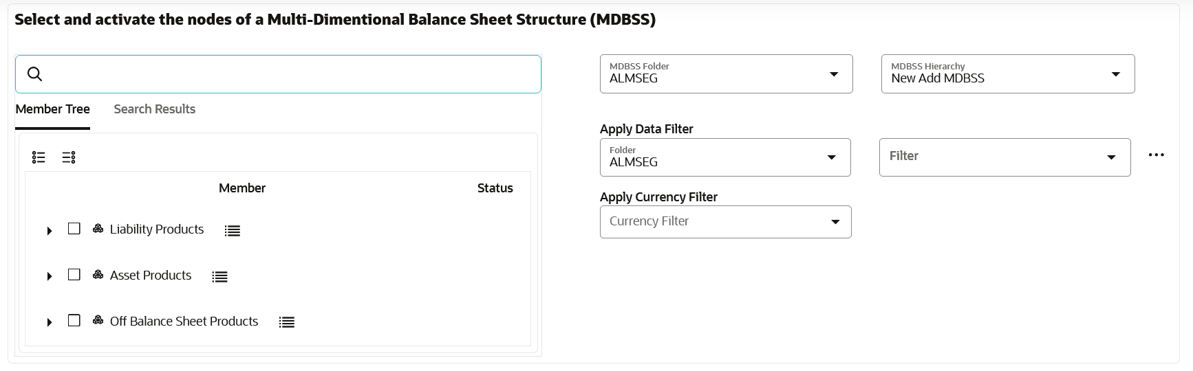

    After selecting the Balance Sheet Source, Multi-Dimentional Balance Sheet Structure (MDBSS) details block is activated.
    Figure 7-320 MDBSS Details
    MDBSS Details
    Enter the Data Source details of Balance Sheet.
    Table 7-96 Data Source details used for Creating Dynamic Deterministic Process
    Member Tree This shows the hierarchical structure and allows you to define rules by selecting the node members from the browser. Select Node and Click Menu icon next to it to view the available options.
    Figure 7-321 Member Tree Selection
    Status of node is also displayed in Member Tree section, for example Selected, and so on. To select member hierarchy, following options are available:
    • Expand self, child and descendants: Allows to expand the selected node itself along with its child and descendants.
    • Expand selected member/branch: Allows to expand the selected node
    • Select self, child: Allows to select the selected node itself along with its child.
    • Select self, child and descendants: Allows to select the selected node itself along with its child and descendants.
    • UnSelect self, child and descendants: Allows to unselect the selected node itself along with its child and descendants.
    Here,you can perform the following tasks on the searched node(s):
    • Add
    • Edit
    • View
    • Delete
    • Copy
    You can also search the members based on the filters.
    To search a member , follow these steps:
    1. Navigate to Assumption Browser section of the Rule Definition page.
    2. Enter the Member ID, Name, Status, or Is Leaf in Search Criteria.
      Figure 7-322 Search Criteria
      Search Criteria
    3. Click Search. The searched member(s) will be displayed in Search Results section of Assumption Browser .
      Figure 7-323 Searching Members
      Searching Members
      Click Show Parentage icon to view the Parent-child Node level hierarchy details of selected Node.
      Use Show Numeric Code Values (Left) icon to view the code value left to the Node name.
      Use Show Numeric Code Values (Right) icon to view the code value right to the Node name.
      Here, you can perform the following tasks on the searched node(s):
      • Add
      • Edit
      • View
      • Delete
      • Copy
    Assumption Browser Select the Product from Assumption Browser and click Add under Action option.
    MDBSS Folder Select the MDBSS folder
    MDBSS Hierarchy Select the MDBSS hierarchy
    Data Filter Folder Select the Folder from which you want to apply Data Filter.
    Data Filter This field allows you to select a subset of data for processing by selecting a filter. You can select a filter that was previously created, or define a new filter on the fly.
    Data filter defined on PORTFOLIO table only can be used in Balance Sheet selection.
    Currency Filter Optionally, apply a currency filter on the selected data.
    Use data from Aggregate Instrument Tables Select Asset Aggregate or Liability Aggregate table type which needs to be included in process. You can use selected aggregate table(s) to construct instrument data view for processing. If this field is blank, then process will use standard tables.

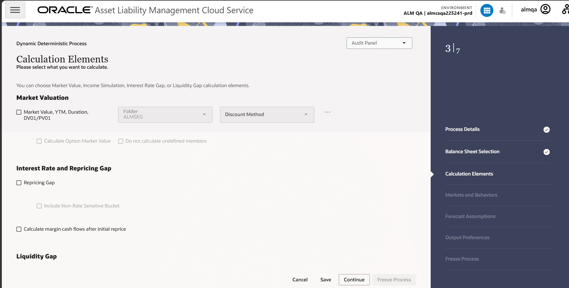

  6. Click Continue to navigate to the Calculation Elements section.
    Figure 7-324 Calculation Elements
  7. Enter the Calculation Elements details as shown in the following table:

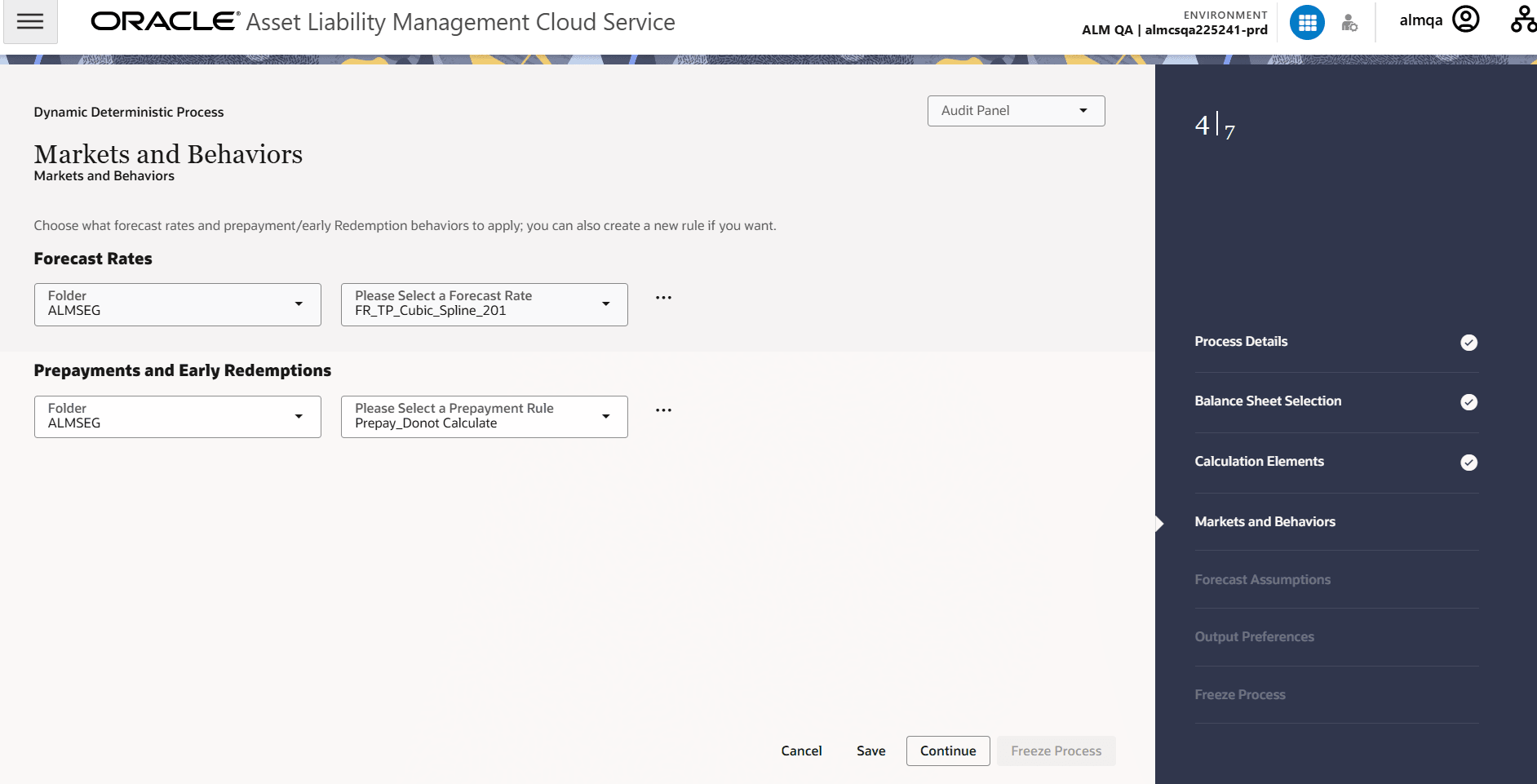

  8. Click Continue to navigate to the Markets and Behaviors section.
    Figure 7-329 Markets and Behaviors
  9. Enter the Markets and Behaviors details as shown in the following table:

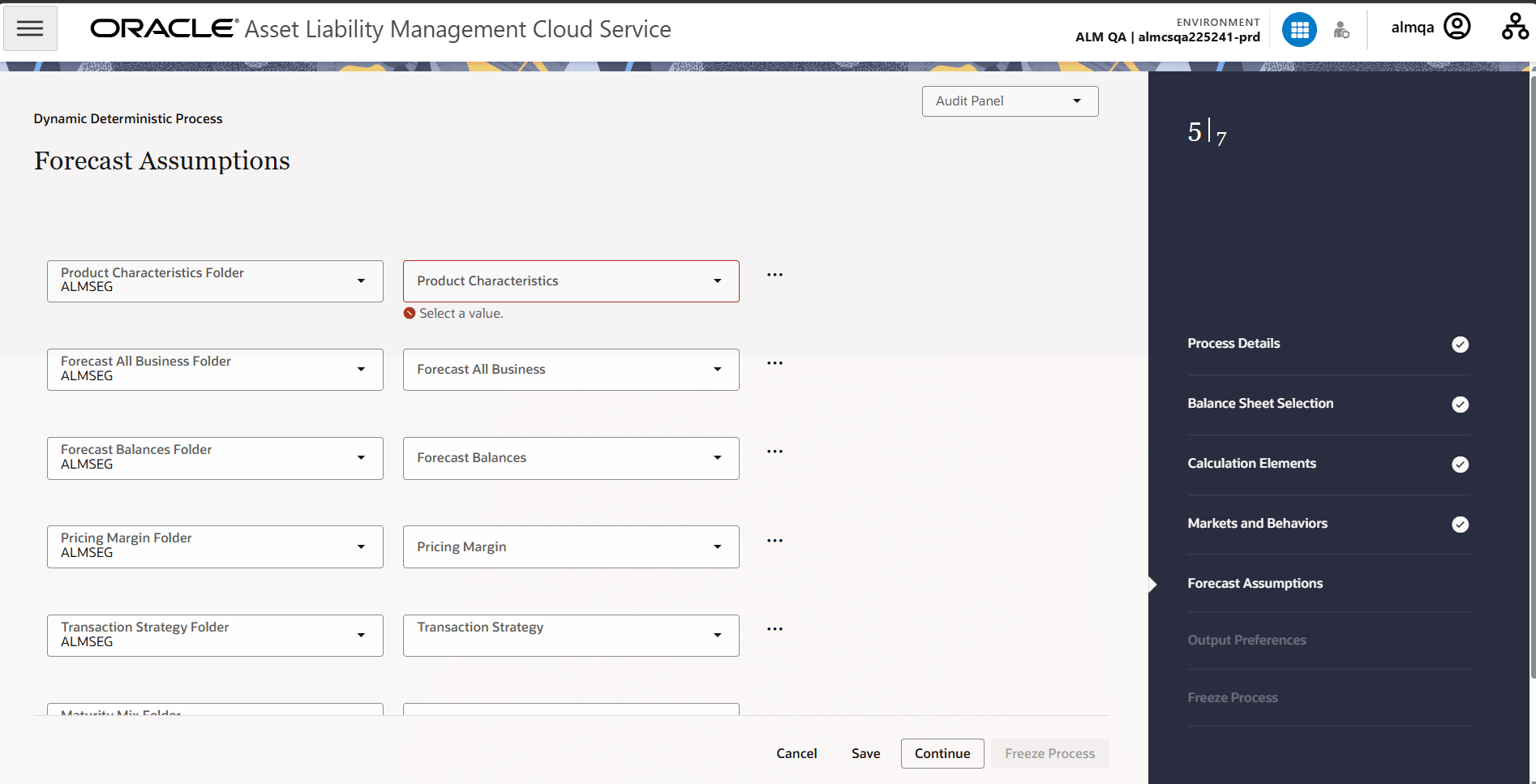

  12. Click Continue to navigate to the Forecast Assumptions section.
    Figure 7-334 Forecast Assumptions
  13. Enter the Forecast Assumptions details as shown in the following table:
    Table 7-101 List of Forecast Assumptions details used for Creating Dynamic Deterministic Process
    Product Characteristics Select the Folder and Product Characteristics Rule you want to be applied to the process. See Product Characteristics to define the Product Characteristics rules.
    Figure 7-335 Product Characteristics
    Forecast All Business Select the Folder and Forecast All Business Rule you want to be applied to the process. See Forecast All Business to define the Forecast All Business rules.
    Figure 7-336 Forecast All Business
    If the Forecast All Business rule is selected, then Forecast Balances and Pricing Margins rules cannot be selected. The Forecast All Business rule is mutually exclusive with the Forecast Balances and Pricing Margins rules.
    Forecast Balances Select the Folder and Forecast Balance Rule you want to be applied to the process. See Forecast Balances to define the Forecast Balance rules.
    Figure 7-337 Forecast Balances
    Forecast Balances
    If the Forecast All Business rule is selected, the Forecast Balances rule cannot be selected. The Forecast All Business rule is mutually exclusive with the Forecast Balances and Pricing Margins rules.
    Pricing Margins Select the Folder and Pricing Margin Rule you want to be applied to the process. See Pricing Margins to define the Pricing Margin rules.
    Figure 7-338 Pricing Margins
    Pricing Margins
    If the Forecast All Business rule is selected, then Pricing Margin rule cannot be selected. The Forecast All Business rule is mutually exclusive with the Forecast Balances and Pricing Margins rules.
    Transaction Strategies Select the Folder and Transaction Strategy Rule you want to be applied to the process. See Transaction Strategies to define the Transaction Strategy rules.
    Figure 7-339 Transaction Strategies
    Maturity Mix Select the Folder and Maturity Mix Rule you want to be applied to the process. See Maturity Mix to define the Maturity Mix rules.
    Figure 7-340 Maturity Mix
    Maturity Mix
    Autobalancing Select Apply Autobalancing check-box to enable the Autobalancing.
    Use autobalancing to maintain a balanced balance sheet, and generate retained earnings. Product leaf members used during the autobalancing process must be defined within your Application Preferences, including: Assets Liabilities Retained .
    If you do not completely define the required autobalancing leaves in Application Preferences, an error message is generated during processing.

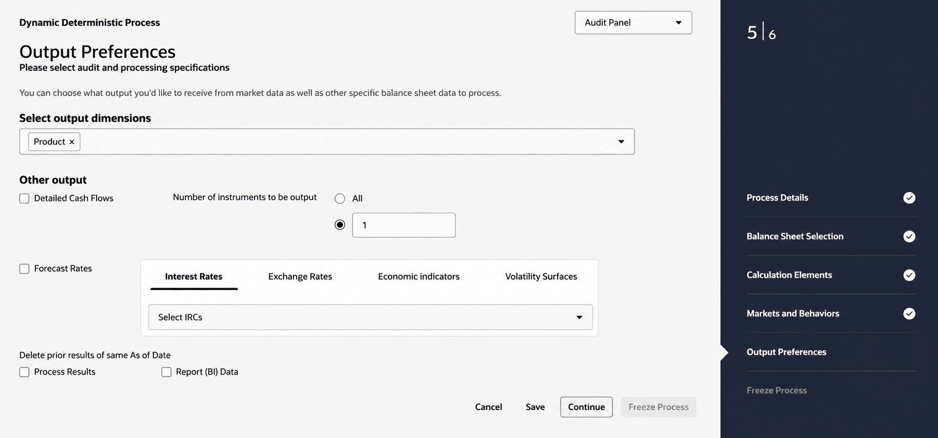

  14. Click Continue to navigate to the Output Preferences section.
    Figure 7-341 Output Preferences
    Output Preferences
  15. Enter the Output Preferences details shown in the following table.
    Detailed Cash Flow - Existing Business
    Check the box to record the instrument detail cash flows occurring for the desired number of records processed. For each record, daily cashflow and market value results are written to the FSI_ALM_CASHFLOW_OUTPUT_HIST and FSI_ALM_CASHFLOW_DYN_MV_OUTPUT_HIST tables.
    Enter desired number of Records in the box or select all records to be output.
    The number of records output directly impact processing time. It is recommended to use this as an Audit function only, with few records chosen.
    Detailed Cash Flow - New Business
    Enter the desired number of Records in the box or select all records to be output.
    The number of records output directly impact processing time. It is recommended to use this as an audit function only, with few records chosen.
    You can also select the specific MDBSS node to record the instrument detail cash flows occurring for the desired number of records processed from the Select MDBSS Nodes to be output list. The number of new business records created depends on new business definition and can range from few to many for a specific MDBSS node.
    For example, forecast balance method of Rollover with multiple Maturity Mix Terms, defined for many modeling time buckets, can create many number of new business records, whereas for forecast balance method of New Add with single Maturity Mix Term, defined for few modeling time bucket, will create few business records.
    Forecast Interest Rates Select the Interest Rate Curves for which you want the engine to write forecasted interest rates in the database table.
    Forecast Exchange Rate Select the Exchange Rates for which you want the engine to write forecasted exchange rates in the database table.
    Forecast Economic Indicators Select the Economic Indicators for which you want the engine to write forecasted interest rates in the database table.
    Volatility Surface Select the Volatility Surfaces for which you want the engine to write forecasted Volatility Surface in the database table.
    Delete prior results of same As of Date
    • Process Results: If this check-box is selected, then engine removes the results of previous process execution ID and As of Date. Engine fetches all the details of the same Process ID and As Of Date from the tables. Process history tables keep track of execution id's whose data has been deleted.
    • Report (BI) Data: If this check-box is selected, then engine moves the results of previous process to BI report before removing the results of previous process execution ID and As of Date.

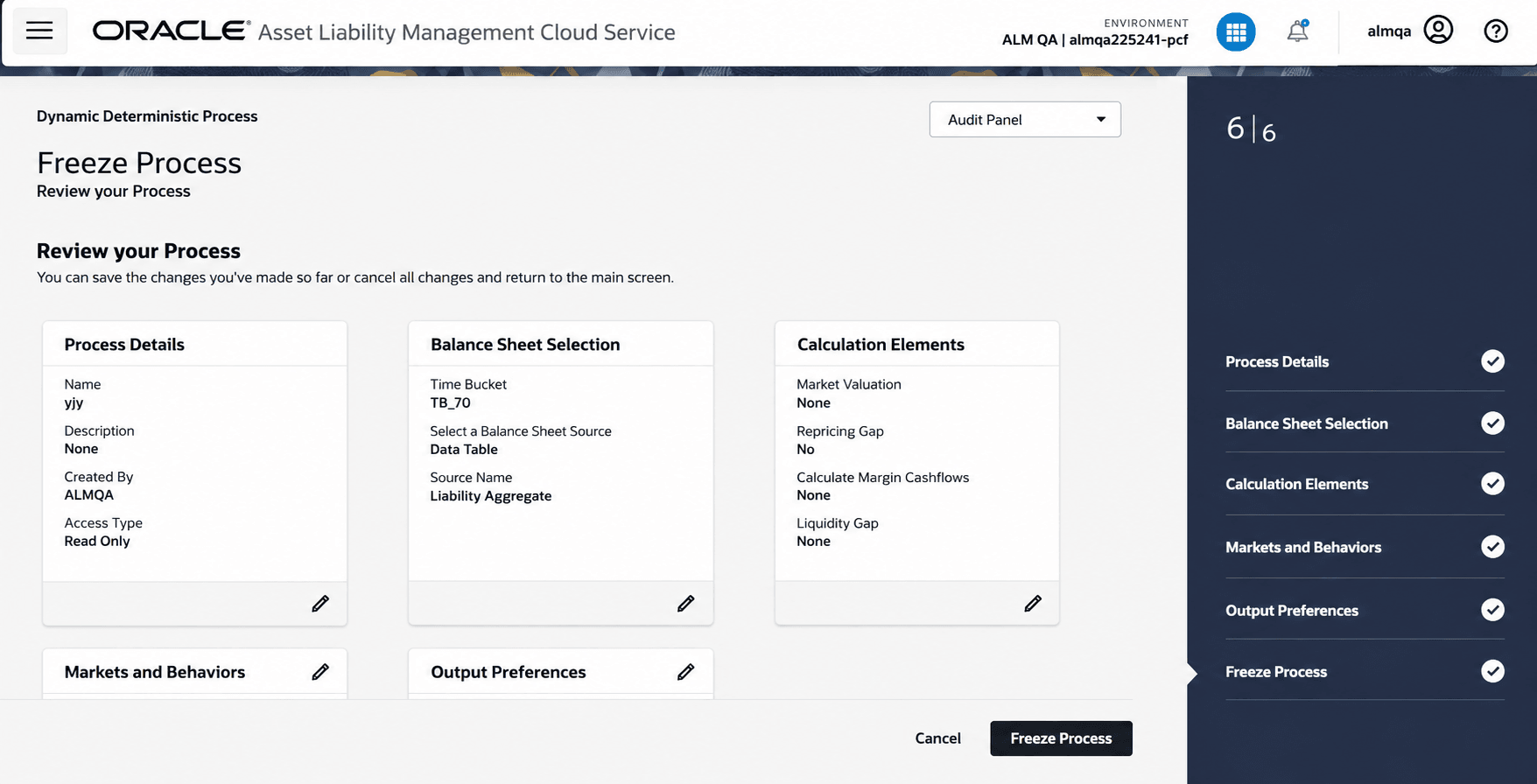

  16. Click Continue to navigate to the Freeze Process section.\
    Figure 7-342 Freeze Process
    Freeze Process
  17. Verify the changes and click Save.
