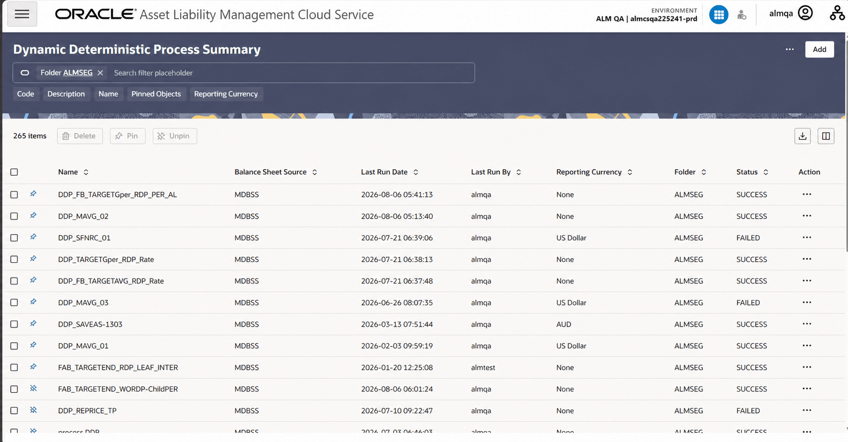

Dynamic Deterministic Process Summary
This page is the gateway to all Dynamic Deterministic Process Rules and related functionality. You can navigate to other pages relating to Dynamic Deterministic Process Rules from this point.
Figure 7-316 Dynamic Deterministic Process Summary
Search Dynamic Deterministic Process
Prerequisites: Predefined Dynamic Deterministic Process

The Dynamic Deterministic Process summary table displays the following columns:
  • Code: Numeric ID associated with a Dynamic Deterministic Process.
  • Name: Displays the Dynamic Deterministic Process's short name.
  • Balance Sheet Source: Displays the instrument table selection for processing of data.
  • Last Run Date: Displays the Date and Time when Dynamic Deterministic Process was run last.
  • Last Run By: Displays the Name of the user who last runs the Dynamic Deterministic Process.
  • Reporting Currency: Displays the currency for consolidated results to be aggregated.
  • Folder: Displays the Folder name where the Dynamic Deterministic Process is saved.
  • Status: Displays the status of the Dynamic Deterministic Process.
  • Access Type: Displays the access type of Rule. It can be Read-Only or Read/Write.
  • Action: Displays the following list of actions that can be performed on the selected Dynamic Deterministic Process.
