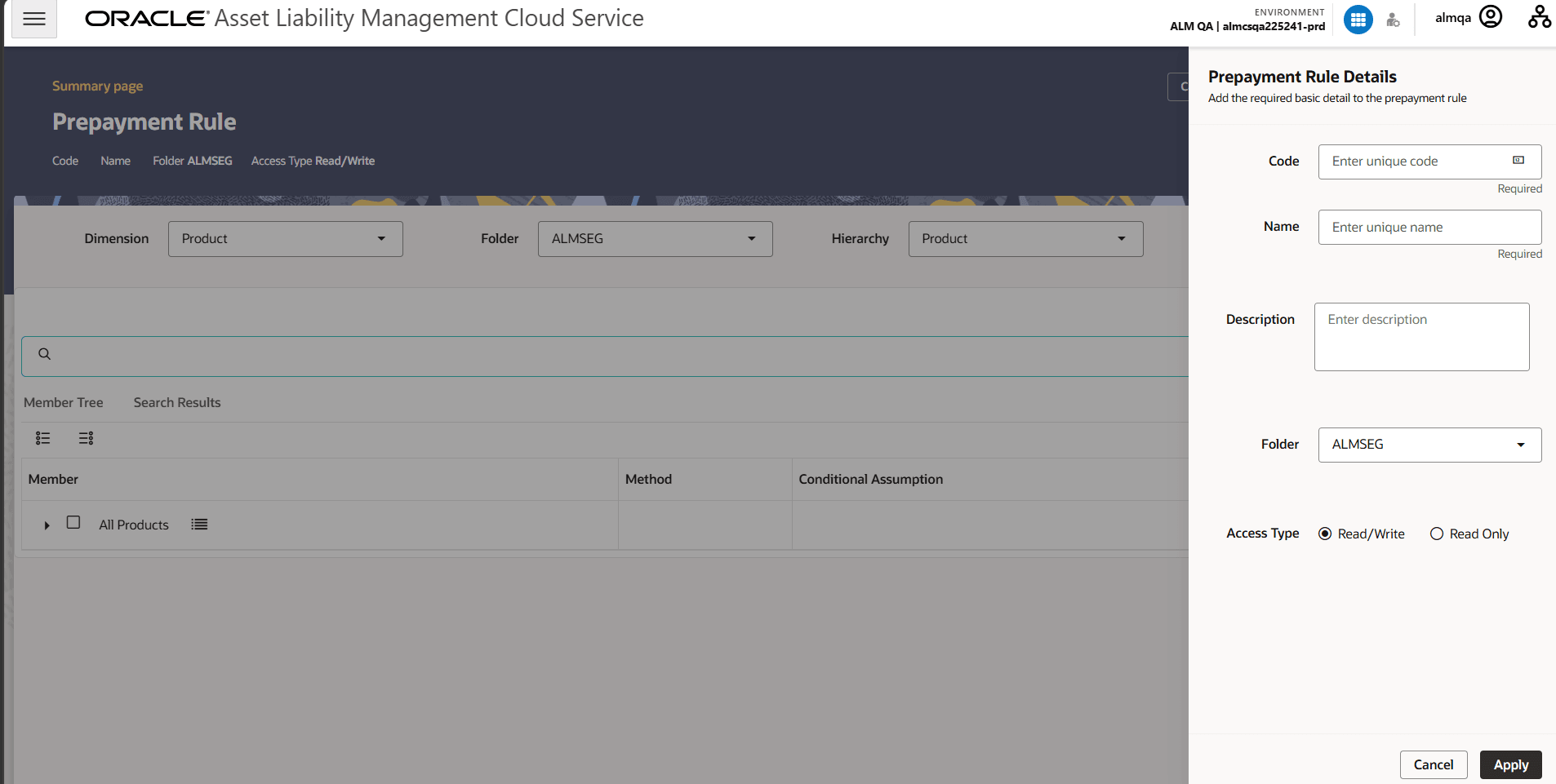

Create Prepayment Rules
You create a Prepayment Rule to define prepayment assumptions for new products.
To create a new Prepayment Rule, follow these steps:
  • Click Add icon from the top of the Prepayment Rule Summary page.
    Figure 7-86 Add Prepayment Rule
    Add Prepayment Rule
  • Enter the following Details.
    • Name: Enter the name of the Prepayment Rule.
    • Code: Enter the code manually, or click Autogenerate to generate it automatically
    • Description (optional): Enter the description of the Prepayment Rule.
    • Folder: Select the Folder where the Prepayment Rule needs to be saved.
    • Access Type: Select the Access Type as Read-Only or Read/Write.
  • Select the Dimension as Common Chart of Accounts, Product, General Ledger Account, or MDBSS.
