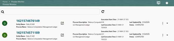

    1. To open the Process Monitor page, in the Process Modeller page, click Process Flow Monitor icon or select Process Flow Monitor from the Process Modeller menu.
      Figure 9-61 Process Monitor Menu
    2. The Process Monitor page opens displaying all the Run instances corresponding to the Balance Computation Management Ledger process. In the Process Monitor page, for the required Run pipeline (process) that was executed, search the Run instance by Process ID, or by the Process Name Balance Computation Management Ledger, and select the process instance.
    Figure 9-62 Balance Computation Management Ledger process – Process Monitor Page – Select Job ID

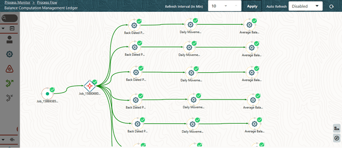

  2. A status page opens, which displays the execution status of the executed Run for the Balance Computation Management Ledger process. In this illustration, the Run for the Daily and Average Balance Computation is successfully executed.
    Figure 9-63 : Balance Computation Management Ledger process – Run Execution status
