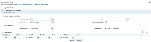

12.7.16.1.2 Adjustment - Fixed Amount
Figure 12-14 Adjustment Rule Details
This illustration is the Adjustment Rule (Definition Mode) that allows you to define the Adjustment Rule Details.
