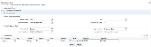

12.7.16.1.3 Adjustment - Formula Based Rate
Figure 12-15 Adjustment Rule Details - Formula Based Rate
This screen allows you to define Adjustment Rule Details - Formula Based Rate.

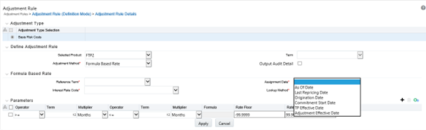

With this method, you also specify the Interest Rate Code and define an Assignment Date for the Rate Lookup. The Interest Rate Code can be any IRC defined within Rate Management, but will commonly be a Hybrid IRC defined as a Spread Curve (for example, Curve A – Curve B).
Assignment Date selections include:
  • As-of-Date
  • Last Repricing Date
  • Origination Date
  • TP Effective Date
  • Adjustment Effective Date
  • Commitment Start Date

Figure 12-16 Adjustment Rate Details - Formula Based Rates
This part of the Adjustment Rule Details screen allows you to define the Term-Point, Coefficient, and Rate Spread.
  • Term Point: This allows you to associate a specific term point from the IRC to each Term Range.
  • Coefficient: This allows you to define a multiplier that is applied to the selected rate.
  • Rate Spread: This allows you to define an incremental rate spread to be included on top of the IRC rate.
The resulting formula for the adjustment rate: (Term Point Rate * Coefficient) + Spread For example:
Figure 12-17 Formula Rate Parameters
This part of the screen displays the defined information. The resulting formula for the adjustment rate: (Term Point Rate * Coefficient) + Spread.
