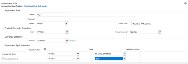

    1. Navigate to the Adjustments Assumption browser page.
      Figure 30-3 Adjustment Rule - Edit Mode
      This screen allows you to edit an existing Adjustment Rule.
