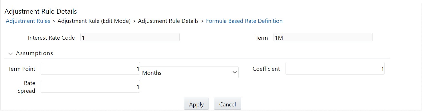

30.2.1.2 Procedure to Define the Formula Based Rate Adjustment Method
Figure 30-5 Formula Based Rate Adjustment Method
Defining the Formula Based Rate adjustment method involves the following additional steps:
  1. Select Update to define the mathematical formula. The Define Formula for Reference Term page is displayed.
  2. Specify the Term Point, Coefficient, and Rate Spread parameters on the Define Formula for Reference Term page.
