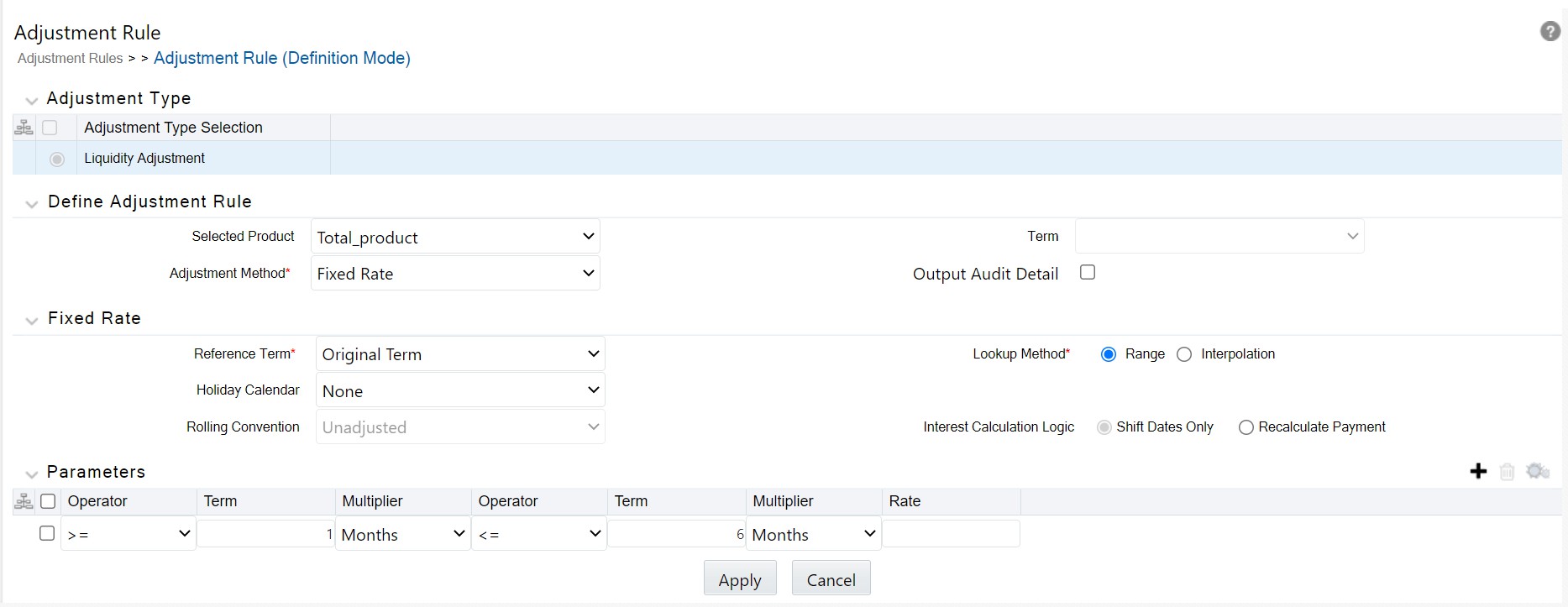

30.2.1.3 Procedure to Define the Fixed Rate Adjustment Method
Figure 30-6 Fixed Rate Adjustment Method
Defining the Fixed Rate adjustment method involves the following additional steps:
  1. Select Update to define the mathematical formula. The Define Formula for Reference Term page is displayed.
  2. Specify the Term Point, Coefficient, and Rate Spread parameters on the Define Formula for Reference Term page.
