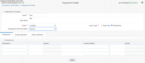

Prepayment Rate Calculation
Select the Manual, Integrated Model, or External Models.
For more information, see the Prepayment Rate Calculation section.
Select prepayment rate calculation, which could either, be a manual, integrated, or external model. To create a Prepayment Model, follow these steps:
  1. Navigate to the Prepayment Model Summary Page.
  2. Complete standard steps for this procedure. For more information, see the Create Rules section.
