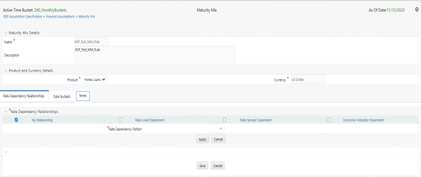

Defining Maturity Mix assumptions involves three primary steps:
  1. Choosing your rate dependency option.
  2. Defining Maturity Mix assumption bucket ranges.
  3. Inputting Maturity Mix assumption details.
Using the default currency to set up assumptions can save data input time. At run time, the calculation engine uses assumptions explicitly defined for a product currency combination. If assumptions are not defined for a currency, the engine uses the assumptions defined for the product and the default currency. If the assumptions are the same across some or all currencies for a specific product, you can input assumptions for the default currency. Be careful using this option on screens where an Interest Rate Code is a required input.
Rate Dependency Relationships
There are four rate dependency options to choose from:
  • No Relationship
  • Rate Level Dependent
  • Rate Spread Dependent
  • Economic Indicator Dependent
Rate Dependency Patterns
If any one of the Rate Dependency options, other than No Relationship, is selected, the Rate Dependency Pattern drop list becomes active. The list of available patterns is limited to those which apply to the selected Rate Dependency Relationship type.
Rate Dependency Patterns are not supported in BSP. For BSP, you must select No Relationship.
